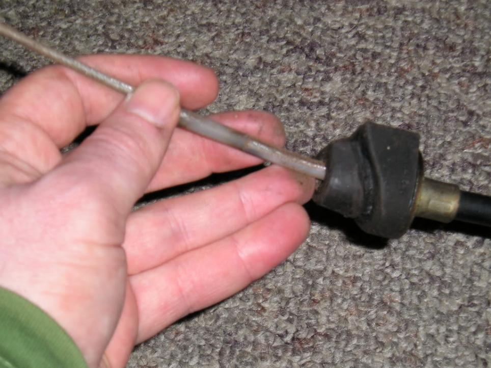

    I replaced the cable today and all seems good now. The cable wasn't fraying, but there is a plastic sleeve thing between the inner and outer cables that was moving and cracking etc. But I think the cause of the actual noise may have been to do with the insulation/foam stiff on the inside of the firewall.

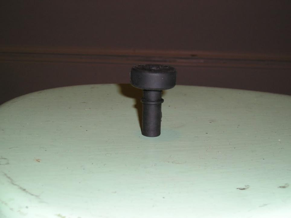

    We had a bit of trouble getting the cable in though. I bought replacement bushes that go in the tab on the gear box to hold the cable in place. But this meant that the cable wasn't quite long enough by a matter of millimetres. The thickness of the bush means the adjusting knob is higher up so the inner cable is too short. So we removed the thicker bush so it would fit.
    Question is, is the very tight fit normal? Is there a way of making it all fit together with all the bushes? A plate has been welded/riveted to the firewall so maybe this has mad the distance the cable has to travel slightly longer?
    The offending bush:
    The old cable:

      Classic signs of a worn clutch cable. They are another thing to replace but the more frequent the better.
      And I have steered clear of non-german aftermarkets as I had a brazilian one in my old Mk1 a few years back (RIP Roadrunner) and I trashed the cable in less than 12 months and about 18000km. There are heaps of OEM german ones out there that might cost more but you won't be under the bonnet and under the dash too often.

        Cheers. Both old and new cables are German. The old one was starting to rust a little and had no lubrication left (if it ever had any). We put quite a bit of light oil down the inner of the new one. Extra smooth.
        Not sure what to do about the bushing - a case of it ain't broke...?

          They are pretty cheap to replace. I found that the new cable tends to find it's way back into the new groove.

            Dont worry about the bushing, some cables need em, others dont. If it works well, its right.
