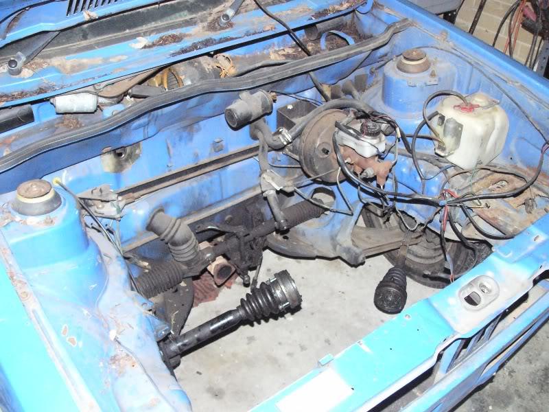

        There was a reinforcing plate available, you can sometimes find them on wrecks or make your own. You can just make it out in this shot.
        Your clutch cable might also be fraying internally.
        I'd remove the cable and just try sliding the cable through the sheath to see if it's catching, you'll also have a clear view of the firewall to spot any cracks.

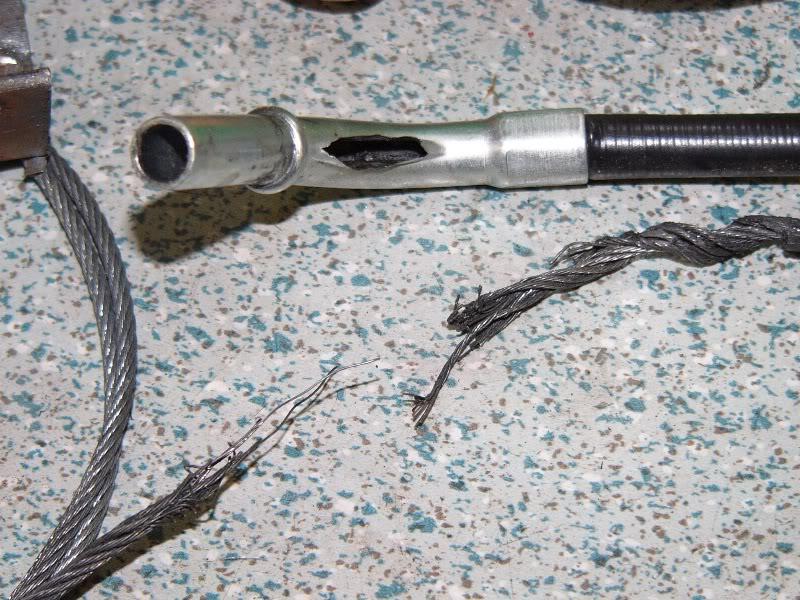

            I had one fray at the bend at the firewall and snap. (This was a diesel cable, they're basically the same but do a 90° bend at the firewall).
            GolfMan came to the rescue with a loaner cable to get us home.
            It had chewed right through the tube without me noticing.
            If you have to install a new cable try and trickle a bit of gearbox oil down the cable and into the sheath, it'll help it last longer.

                            Originally posted by Peter Jones View Post
                            Pete
                            i'd bet this is your problem mate. i've had it happen too, just like this photo of petes.
                            new cable time.
