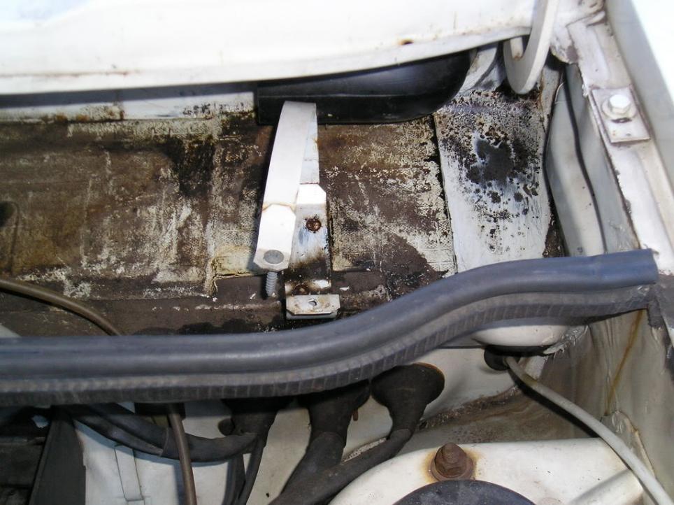

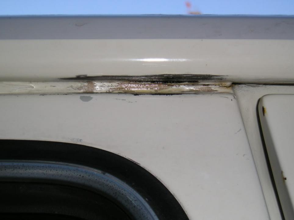

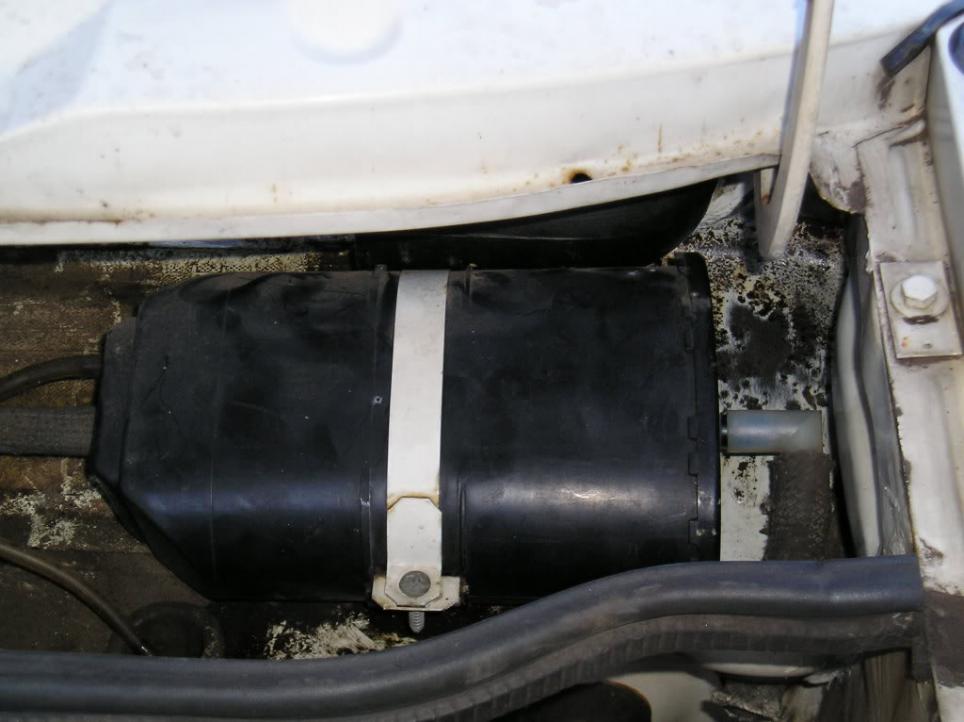

        Today's progress. A bit o rust in the rain tray where leaves and other crap collects. Rust killer then fish oil applied.
        Before:
        And now:
        And the worst of the roof gutter bit now:

            what is the acid rust killer stuff you applied?
              Thanks lads.
              I used 2 sorts - one K&H spray stuff for bigger areas, the other a brand I can't recall in a bottle which I apply with a cotton bud for small areas. Both seem pretty good - you can see the difference in minutes. But it's pretty toxic so I wear gloves when using it. Fish oil was K&H brand too.
