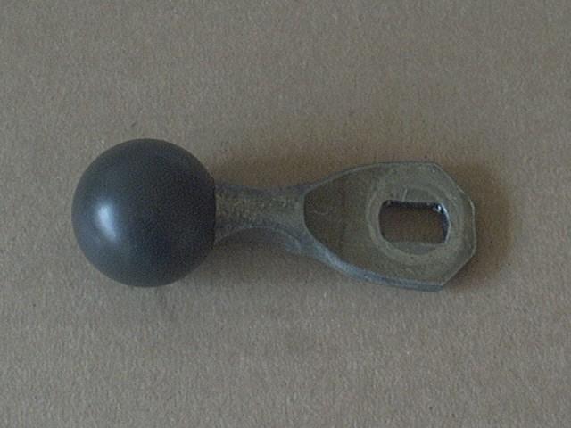

      While I was under there I noticed the rubber ball on the lever (pic of new one below) had worn completely off!
      If any one has a good one of these for sale PM me..
      (also looking for bushing set, but will order from OS if unavailable)
