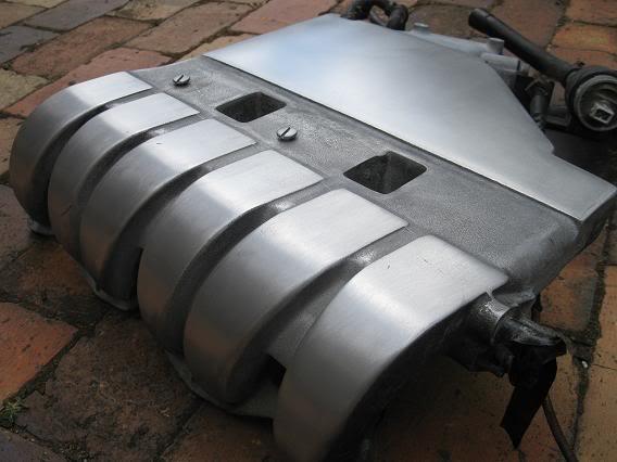

                • bit more sanding and fiddling in the beige today, another coat of rust stuff, need another trip to the hardware joint for kill rust next i reckon (or por-15 if only they bloody sold it near me) the rust stuff ive got isnt too bad but seems a bit light on, anyway,
                  so spent some time fixing a few little things and some paint on someone elses yellow mk1,
                  then decided to so a little sanding and chuck some polish on a vr manifold.
                  still needs more sanding though.
                  mmm, coffee n bikkies, sanding can wait lol
