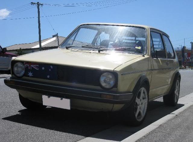

  • for an australia day cruise tomorrow..

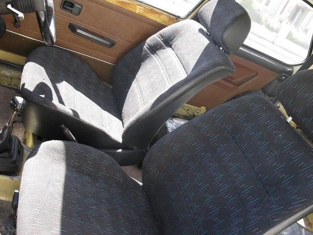

    and thought it was about time for the mk3 seats to go in...

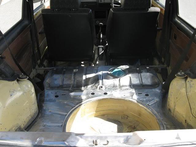

    and got the rear inside done yesterday ready for some rust kill/proofin..
    (yes i know ive missed the wheel well and side bits, theyre next lol)
    also put bunch of other decorative bits of crap inside. but they werent all that photo-worthy.

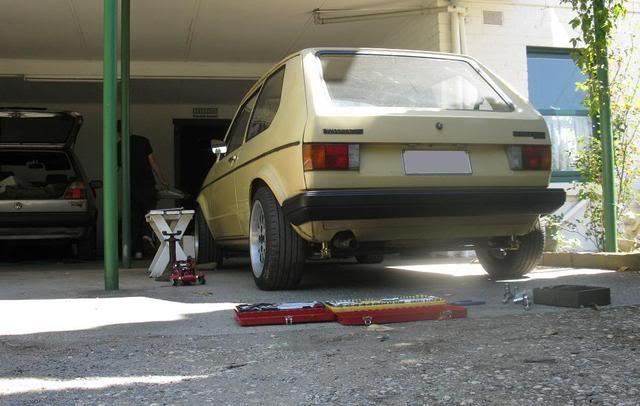

    • Lowered the roof-racks and added some timber...

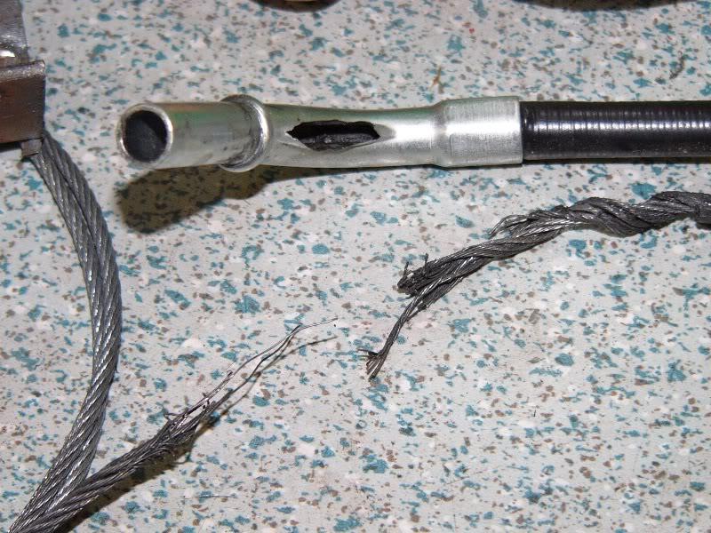

      • Swapped out the loaner clutch cable from Golf Man. Here's a pic of the one that snapped. It had gotten right through the tube before It finally went.
        Thanks again Josh.
          Loves it Any side on shots
          • nice roof racks, I like em!
              I only snapped 3 shots, here is the closest to side on.
              I also need to recoat it as I think that I have missed some spots with the varnish... When it rained you could see where it wasn't...
              I have 3 more major tasks to complete and then I will leave it alone I think - so hope to have it done by end of Feb.

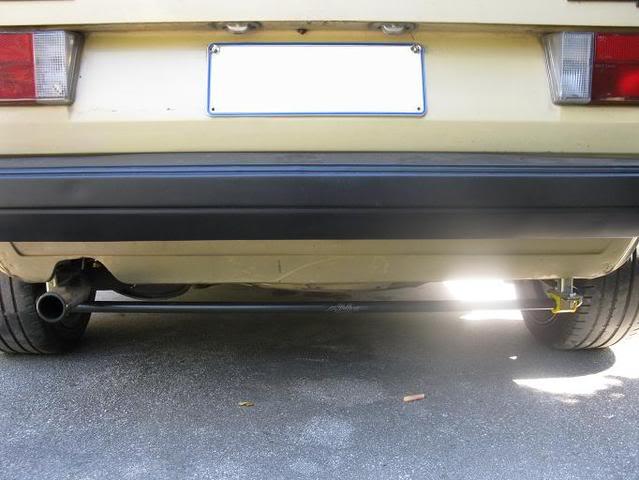

                          recently chucked a 24mil rear sway on the old beige thing, and the improvement in handling is unreal! a little more taily, but turns in harder and stays flat through the corner. love it.
                          so thought id better recommend Selbys for sway bars to all mk1 owners that love hookin into the twisty stuff!

                            • Hey Dom, the swaybars are good but they break the mountings off the body in no time mate. Those "mountings" were only put there to carry the body along the assembly line as are the 2 round holes in the section behind the front arch area.
                              I ran the GTI and selbys rear bars in competition but reinforced the brackets on the body for the selbys bar after getting black flagged during a race at Baskerville when the flaggies saw it flapping around!
                              Andrew
                              • Originally posted by gtimk5 View Post
                                Andrew
                                This is too true, I remember doing a pizza delivery (yes, in my mk1) and the rear sway bar hanging down the the mount scraping on the road.
                                Def re-inforce it Dom
