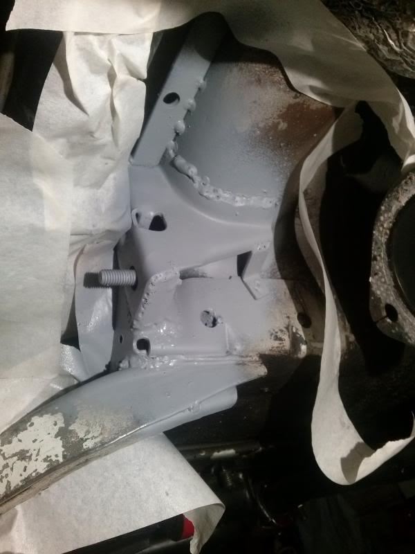

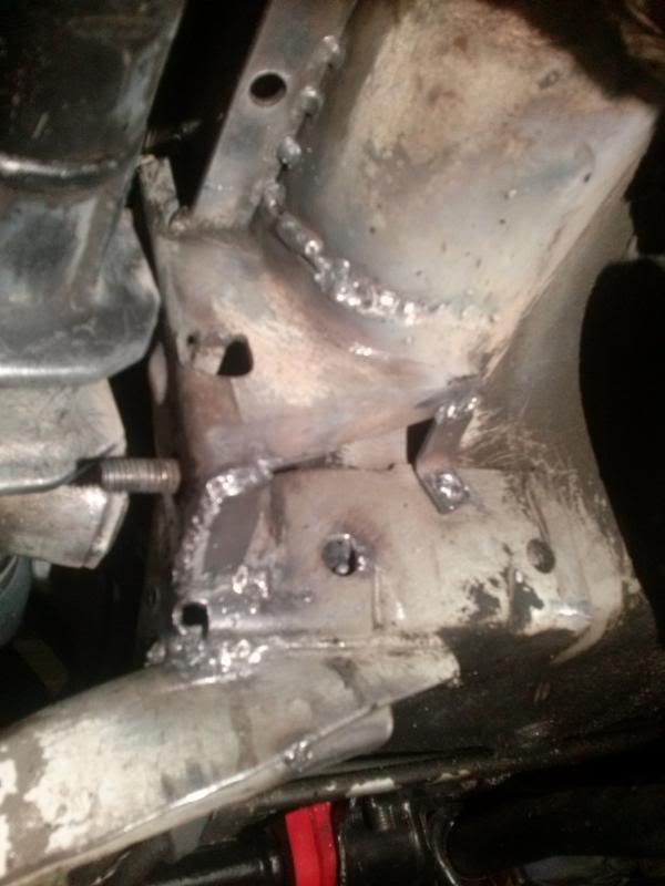

    • I have been noticing a creaking sound when turning at low speeds. I got my wife to move the steering wheel left and right while I checked the rack, turns out as I suspected there was some movement in the drivers side bracket.
      Pulled things apart and I found 2 hairline cracks down underneath where the bracket is spot welded to the underside. So time to reinforce the sucker. I mainly seam welded all the various joins, but I also added a couple of extra pieces in for bracing. Should be right now! I already had a piece of flat bar joining both brackets (you can see the underside of it in the pics) and this still happened. I'd recommend checking your mk1's so you catch this before the cracks get nasty, or worse still the bracket comes right off.

          Yep, the cabrios have more weight too, as does mine with an ABF and heavier box etc, so it makes the load even worse. Also, the real load is almost all on that one bracket, its the side of the rack that limits any sideways movement, the other side is free to move through the bush. Maybe the other bracket is stronger for the original LHD configuration. Anyway, a worthwhile area to check and definitely strengthen if you already have the motor out or at least have the downpipe removed.
          • yep, 100% right.
            Quite fiddly to do with the dp in, but managable.

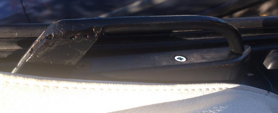

              • Being the tight arse that I am, I decided to build a replacement roof securing handle...
                A few scraps of metal, a drill/grinder/welder, and some paint, and now I have this...
                Apart from the average welding, it looks great, and works even better...

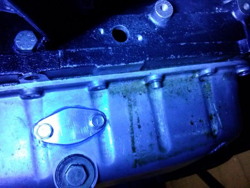

                  And here is my recent mod, new turbo oil drain location on the ABF, this time above oil level. Not an easy location to drill through 7mm of cast iron with engine still in car.
