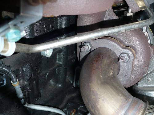

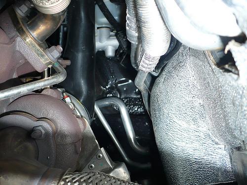

          It should be a VNT-15. I have have some (bad) photos of mine below:
          Apologies for the bad image quality but it is very hard to get your hand behind the back of the engine...
