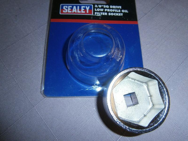

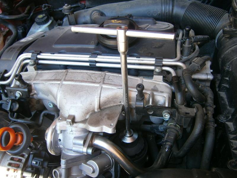

    After struggling for years with the clumsy 3/4 drive setup that I had in my toolbox I came across this 3/8 drive 6 sided 32mm socket. Purchased on EbayUK for just over $20 including postage. Works a treat & is easy to use with a torque wrench. Fits my TDI Golf & TDI Tiguan.

    Why is a 32mm size bolt head required on the oil filter cap is beyond me, surely something smaller and more common like a 18mm would be plenty big enough???
    Nice find though, I had a 1/2" drive 32mm socket laying about so i'll make do with that....
      As you know the cap is made of plastic & maybe VW designers thought that a larger hex would last the distance better with less chance of rounding off. I can imagine an adjustable spanner would be used by many & over a lifetime this cap would be removed many times.
      Even with the smaller dia. shank on the 3/8 drive, it touches the metal above that pulls it slightly off the hex. With the 3/4 drive it was even worse.

            most 1/2" sets go to 32mm, and if you have wobble ends on your extensions (like on kingchrome) then you can angulate the extension enough to happily clear the manifold.
