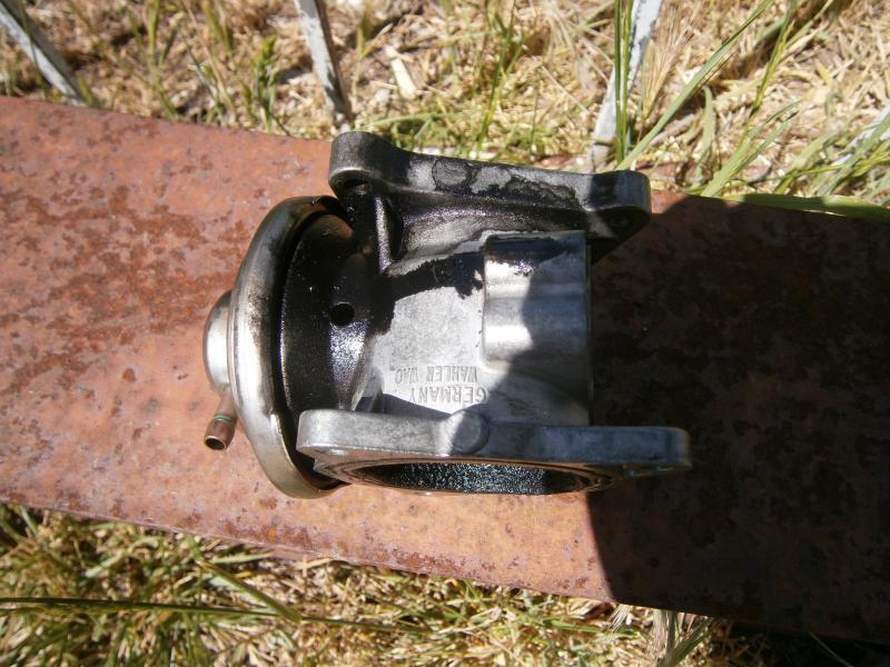

There was oil coming from the vent hole on the EGR as well as at the joins in the boost tube. Transporter had mentioned in an early thread that every Mk5 Golf he had looked at, including their own had oil appearing from the same places.
Here is mine after removal.

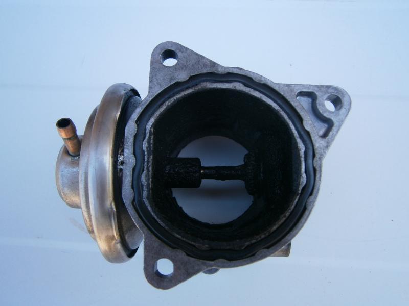

I was expecting the throat to be very blocked as others have posted but mine had only a small amount of carbon covered in oil. I believe that is a result of my driving style. I don't boot it at low revs.
I wasn't able to check the diaphragm for leaks because I don't have a vacuum pump. Before I could look to see if the spindle was clean where it enters the body my friend who was with me pushed on the valve[where the exhaust gas enters] with a screwdriver & the valve opened.

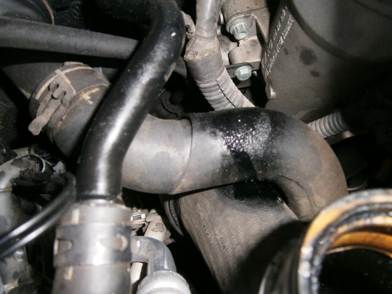

This pictures is of the sleeve that VW has fitted over a coolant hose that I believe is to protect the rubber from the oil that will leak from EGR. Not an if but a when.
