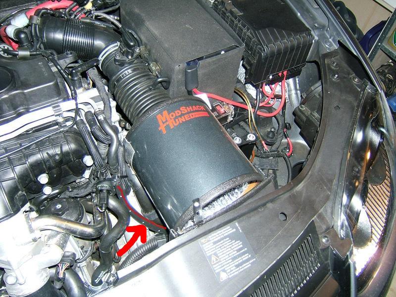

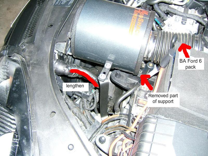

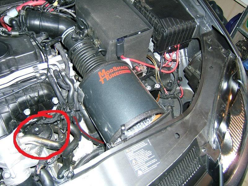

OK, been slow lately thanks to work going nuts, but the Mod Shack housing is in. Unlike Mik's pioneering example in his thread, I got the larger, shorter TTDA housing only, as the dry Apexi pod I am running draws air around the edge, and is far less long and skinny than the nice thin and pointy K&N one supplied in Mik's example. I must point out that the MAF and inlet is absolutely pristine with no fine dust at all, so the dry filter is doing the job nicely. When I did the swap I was able to tap the filter and get some bugs and a bit of dirt out, so it will be a routine item to pull out and clean, probably with some compressed air from the inside out.
In Mik's pictorial, you can see the problem he faced was length ( steady...) whereas I have a thickness issue.

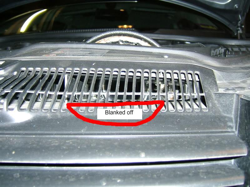

Seriously, there isn't a ton of room around the Apexi, but I did get the extra thick insulation upgrade. I will say that Steve from Modshack obviously LOVES fabbing up project airboxes, and his e-mails to me were excellent. The quality of the product is great, and I'm very happy. Steve charged me $185USD delivered with a blank front plate, extra insulation, and just a 75mm hole in the rear. All I had to do was drill the Apexi holes ( easy ) and mount the holder bracket ( a little tricky ). I have thus far blanked off about 1/3 of the front in line with the radiator by silastic-ing in a segment of the front end plate. This picture explains it better, as below the inlet is blanked off. If I wasn't planning a full sealed front, I'd block off some of the top as well, like my earlier bucket version ( which is now available Jamie! )

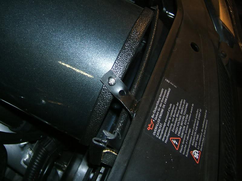

The top of the housing rubs on the bonnet liner, but it's not bad. I was trying to mount it as high as possible to get as much of the width of the stock over radiator inlet into the bucket as possible. Down below you have to watch the radiator fan, and I've mounted mine as close as I could. It has a few mm clearance, and is pretty solid with the temporary upper support bracket. Once I make the front, sealed "lid" it will ensure it doesn't rub. Still working this out, but most likely fibreglass.
