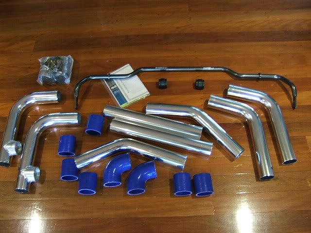

        Been a quiet week on the dirty hands front, but been spending all my money. This month should be fun
        Here's just some of what the nice mailman delivered just today!

        Oooh, nice pressies from the mail man.
        More things for me to buy now.
        Are you going to do a dyno run before and after fitting all this nice pipework to see what difference it makes.?

            Yep a universal e-bay intercooler kit, obviously chinese, but looks fine to me. This set pretty much covers 95% of what I need, and cost a massive $168 delivered from the states.
            The bar is a 22mm rear H&R from G&C. Quality item!
                This sounds very interesting and you will have to keep me posted on this one.
