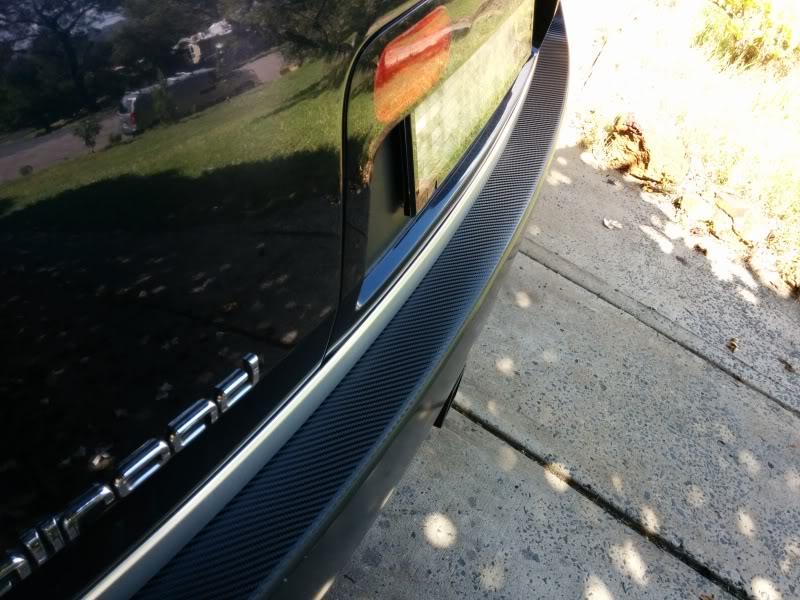

    Carbon film on the bumper:

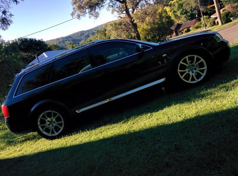

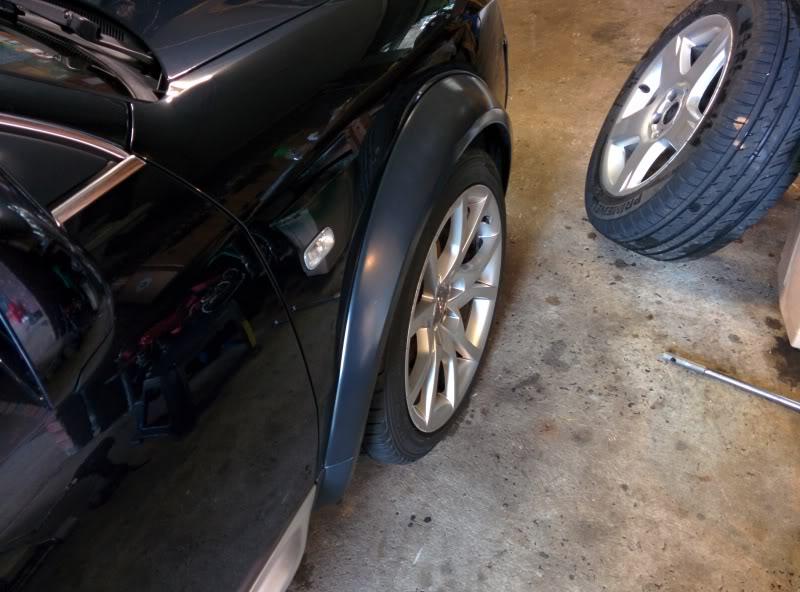

    Test fit S5 rim on high 1
    and on 'sport':

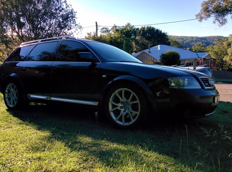

    and the whole car whilst we were having lunch a few weekends ago:

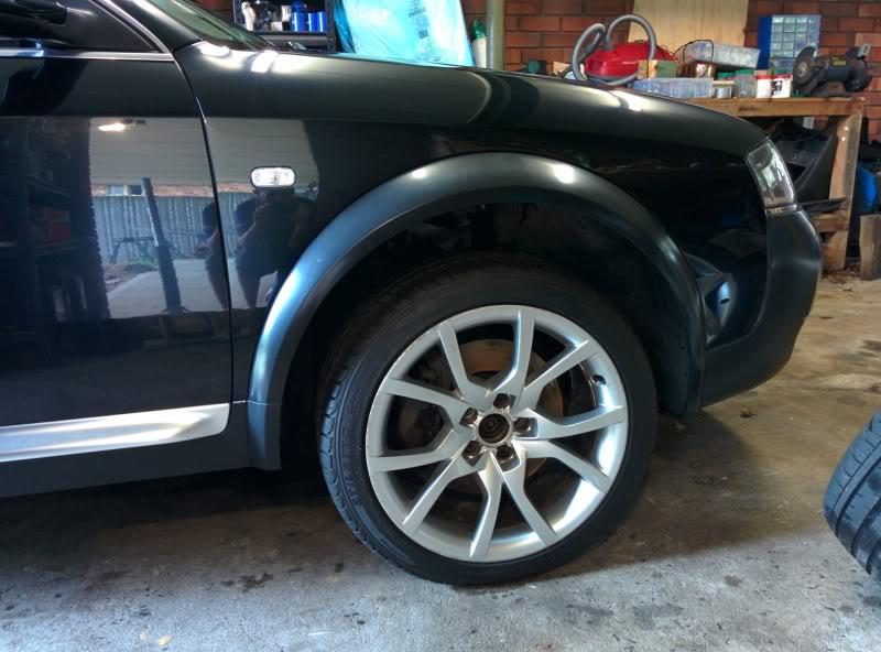

                I got some new tyres on the S5 rims today... for those interested, the rims are 18x8.5 ET29, and the tyres are MOMO 245/45's. The S5 wheels fit just nicely without any spacers or anything. Any more offset (ie ET30 and over) would result in fouling on the suspension on the inside, so these are as far in as you can go with an 8.5" rim.

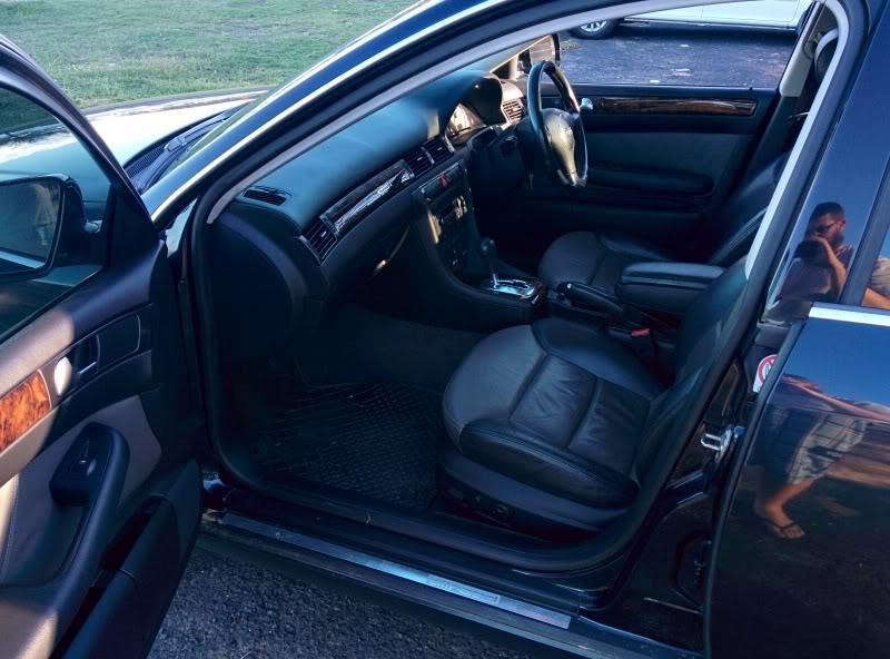

                Inside shots as requested... apologies the whole car is looking rather 'used' and is quite dirty.

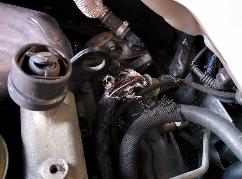

                          Rat bastard:
                          Luckily he (or she) didnt get through any copper, so some silicone tape and its all fixed. I am now running without the engine cover on, as I think the rat was attracted to the (what must be) tasty sound isolating foam glued onto the underside of the engine cover.
