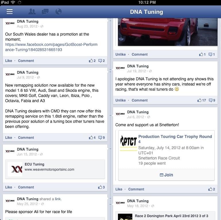

      I would suggest that you avoid the cheap and nasty plug in style "tuning boxes" and go with a proper remap which is loaded onto your cars ECU.
      I know DNA Tuning have a tune available for the 1.6TDI (see screenshot from their Facebook page below) and they have a dealer in Melbourne which is handy for you.
