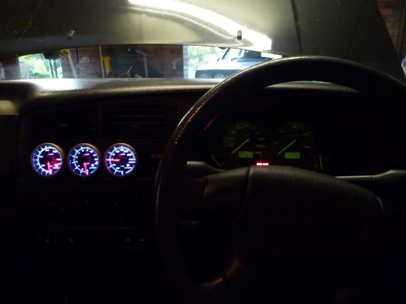

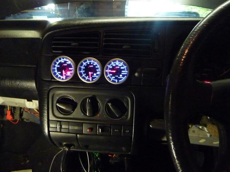

                        After a rather more relaxed day today putting everything back together (I also refurbished the little air deflector flaps inside the HVAC system after ofcourse all of the foam matting blew out of the vents over the past few years) I set to work re-installing my gauges with the new 42DD gauge holder.

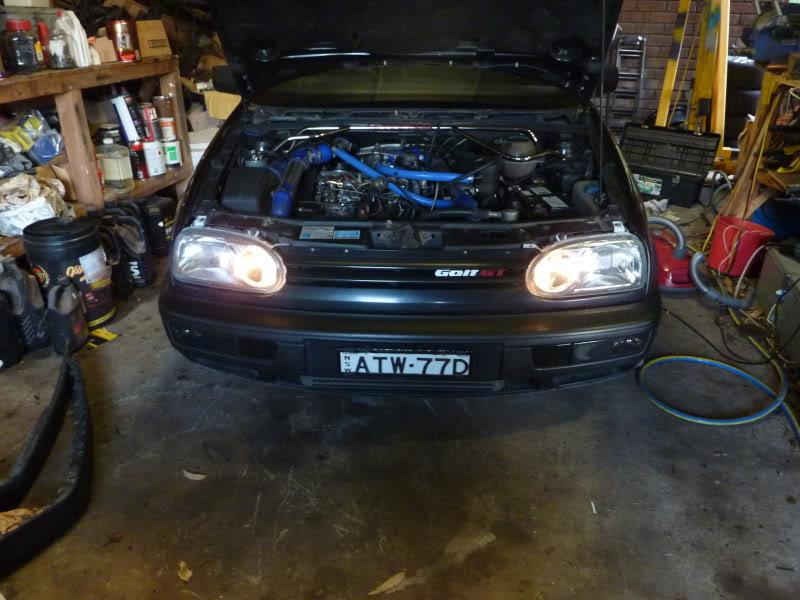

                        my new duel chamber headlights

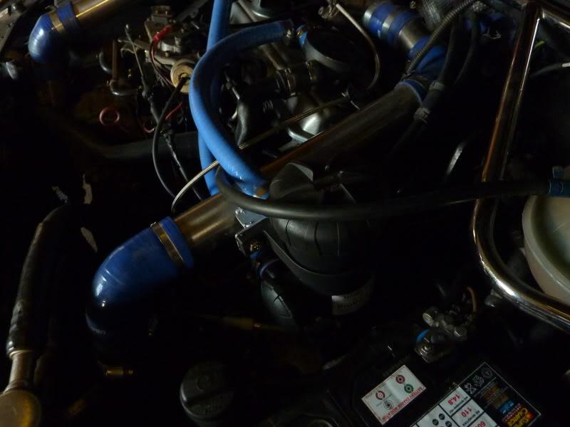

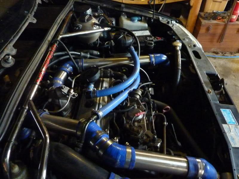

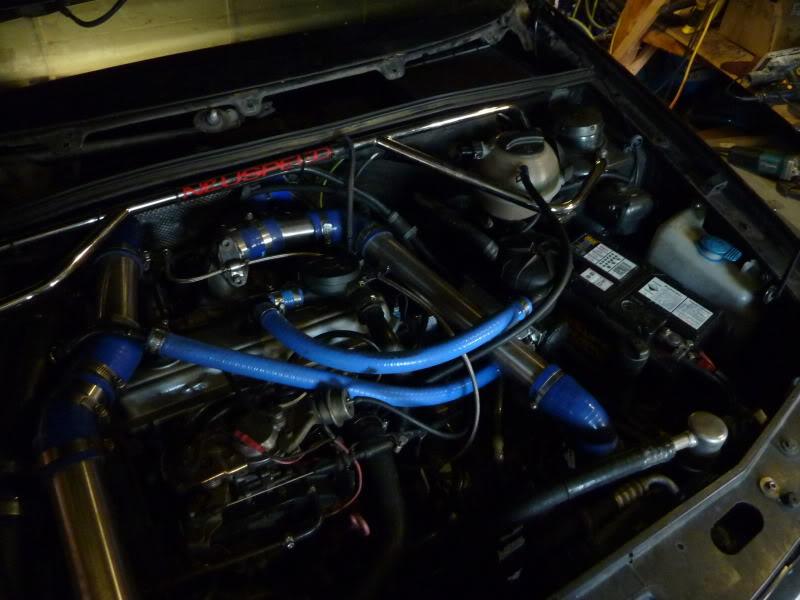

                        and my provent 200
                        I made a bracket for the provent straight off of one of the charge pipes, for lack of anywhere else really good to put it. For now I have a little clear PVC pipe with a tap in it coming off the drain so that I can see when its cought some oil and dimply drain it under the car.
