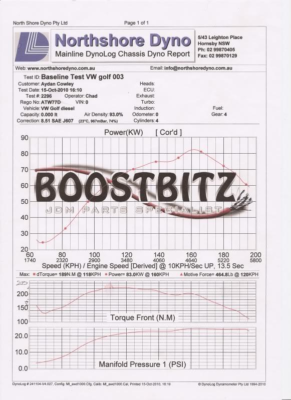

                    • OK did the dyno run.
                      3 runs, made 83kW every time.... thats 110hp in the old speak. I'll put up the scan of the print out when I get home later for you.
                      Torque curve is interesting, and I'm a bit confused by the whole deal because the scale on the torque curve seems to be out, but the peak value (not on the curve, but the number printed) correlates perfectly to the power curve.... maybe the scale is wrong. I'll go grab another print out on monday with a correct scale.
                      Anyway, it was extremely consistent and rev'd all the way to 5600RPM!!!!! Power really falls off past 4700 though.
                      As for the tune, its not too smokey at the moment, i'm convinced it would make a lot more power if t wasnt running out of fuel so much at high revs. A/F ratio went from 9:1 at 1800rpm (off boost) all the way to 30:1 at peak power. Best for power in a diesel is about 15:1, so theres plenty of power to be had there, if I can mod the pump to do it.
                      On the downside, its really obvious how it doesnt get going under 3000rpm, mainly because of the turbo lag. And, I can't help thinking that I could make 110hp with the K14 (though maybe a bit lower in the rpm range), and gain a bunch of torque to boot.
                      We shall see. Maybe I just need ot join the VNT crowd?

                        • Bet thats one of the weirdest VW diesel dyno plots around.
                          Notice how much more like a petrol car's the power curve is.
                          I'm a little disappointed (but not surprised) at the low peak torque value. I really put that down to lag - its easy to see the turbo really doesnt wake up until 3000rpm. But then, its also pretty obvious that it does reasonably well up to 4700, which is much higher than I thought it would be worth revving to.
                          I will now look at doing some "passive" mods to improve hhe low down torque - maybe some exhaust modifications (delete muffler and maybe make a new down pipe for earlier spool) and I really want to get in and make an intake manifold with nice long runners, because the stock manifold is absolute trash. That, I reckon, could make a big difference overall, and with a little extra fueling, i don't see why an extra 10-20hp isn't available just with those mods.
                          I've gotta say though, its nice to put a number to my efforts so far - and given that this beast was 74hp (at the flywheel) when it rolled off the production line 16 years ago, and now 253,000km later it can make 110hp at the wheels, I'm pretty happy
