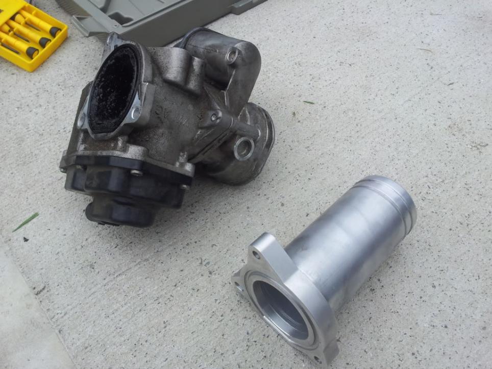

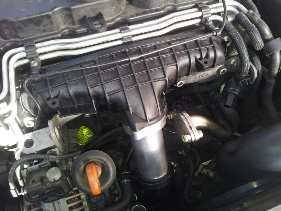

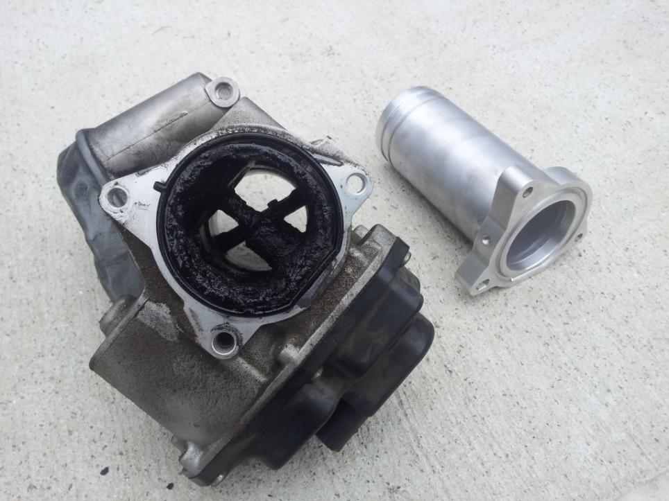

                              EGR delete pipe is in. Had to cut the metal connector off the end of the rubber hose with a Stanley so I could push it over the end of the delete pipe. The rubber hose ends up being a bit short because of this and It was a little difficult to bend it up and get it to fit properly. Probably should try and get a replacement silicone hose or something.
                              Also you need an extra bolt that didn't come with the kit, there is one really long bolt that goes up through the ASV and EGR and bolts into the intake manifold that you can't reuse. You can reuse the other two bolts that hold the EGR valve onto the manifold.
                              I replaced all three with M6x18mm socket caps.
                              Cleaned out the intake manifold as best as I could as well. Still didn't get all the crap out I have no idea how you can get into all the nooks and crannies. When taking the manifold off you might want to know that there is a bolt inside where the intake pipe connects, took me a while to find that one
                              Golf GT Sport TDI
                              • #30
                                Had the same issue with the bolt inside the intake. It was covered in sludge. I left my intake in a tub full of heavy duty degreaser and then cleaned the gunk with a toothbrush followed by stuffing a rag strip in each inlet and used it like a piece of floss. Very messy.
