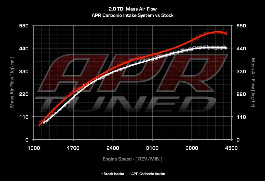

                Edit.. After reading that thread on tdiclub I might do some logging with VCDS and tape up part of the intake behind the grill and see if the MAF airflow is any less. This should tell me if the stock airbox is on its limit or still has reserve.
                Edit2. Graph on APR website shows a gain of 18g/s above 3800rpm. It indicates that the stock airbox is limited at 122g/s.

                  I think the consensus is, without a proper tune an aftermarket air intake gives zero gains or in some cases actually flow less air. WITH a proper tune however, there is definitely an improvement, but the question is how much. It's generally agreed that to take full advantage of a good intake upgrade you'd need to have supporting mods such as bigger turbo, intercooler etc. Having said that, the intake will make more noise and help a little with turbo spool, and for some that plus the visual aspects is enough to justify the cost.

                  I'm not sure how much of that tdiclub thread you have read, but it seems that any increase in the K&N filter's air flow is at the cost of a lot more dirt. Besides that, that filter is a known MAF killer and a damaged MAF will actually make more smoke and restrict your air intake. In fact I'm considering that as a possible atm for the smoke issues I'm having...
                  BTW I would take any graph without proper logs / charts from APR with a grain of salt.
                    Yep I think so. Compare these.. 440kg/hr = 122g/s, 550kg/hr = 153g/s.
                    If it was 122g/s at 4300 rpm as according to the APR graph that would only be 851mg per stroke which is way too low. Porkies APR?
                    MAF g/s
                    MAF mg/stk
                    You can see it does flatten out a bit at 170g/s. So it does seem like there is some restriction there at high RPM, its easier to see on the mg/stk graph, where the mg/stk drops at high RPM. But I'm thinking this may be because of the volumetric efficiency of the engine at high RPM.. someone with a Carbonio and VCDS care to test my theory? (I'm looking at you DkN)

                      I do have a WOT run log of both MAF g/s and mg/str, I can tell you that mg/stroke flattens at 1400 from about 1800rpm and starts dropping at about 3300rpm, dipping sharper from 3800rpm. That's about on par to yours.
                      g/s also follows your curve but peaks a bit higher at 180 at 4000 rpm. It dipped a little before flattening at 180, not sure what that was but as I said this is just one WOT run. I could post up the graph but I've pretty much described all there is to it here, one WOT run is not much data.
