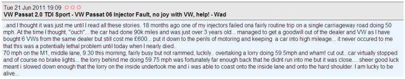

                  • I'd take a water burn to the foot over a truck rear ender at 100kph... just got this sent to me.......
                    This is my ENTIRE gripe, it isn't a leaking sunroof or rattles in the dash, it's going to get someone hurt.
                    • Yeah that is scary - I wonder how sudden the engine shutdown and a stop is, I wonder If I'd have enough time to put the clutch in and just coast slowly to the side if that ever happened.
