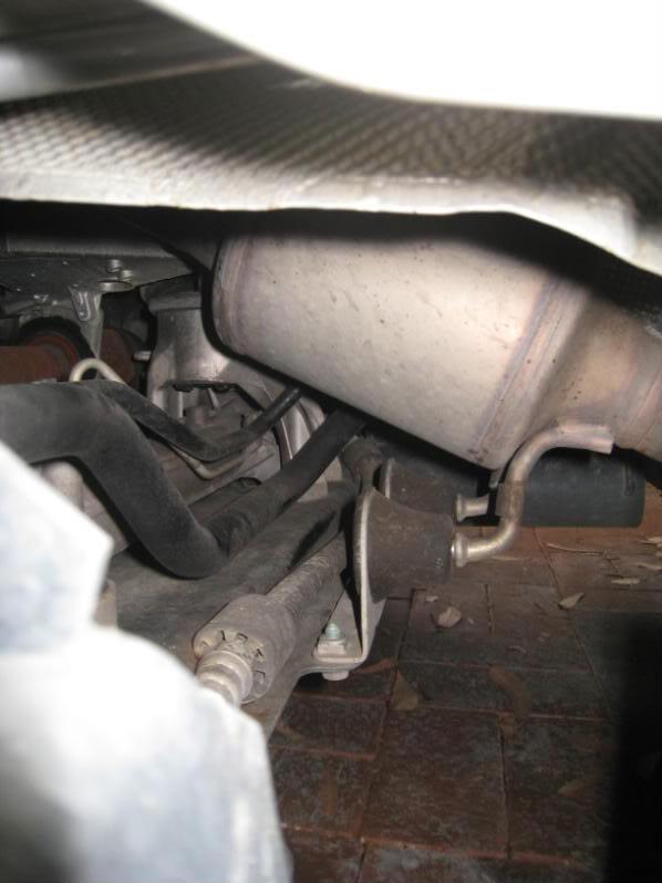

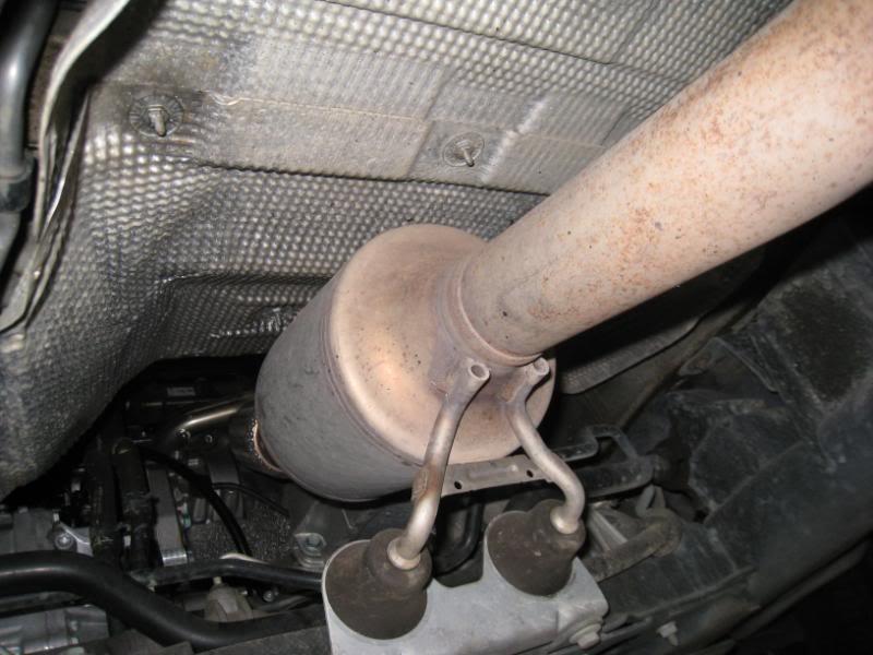

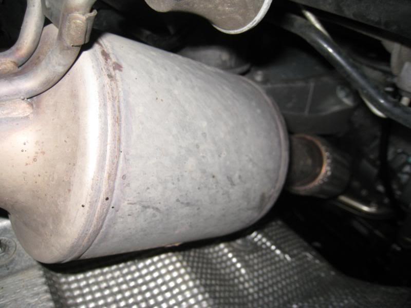

                      Had a good poke around underneath last night, couldn't find any wires or sensors
                      Found some other posts here, such as
                      Originally posted by Ivo View Post
                      Is this a DPF?
                      Mines the same as these pics, so no DPF
                      Ta
                      M
                        If it weren't for the absent O2 I would have said yes. It sure looks like one
