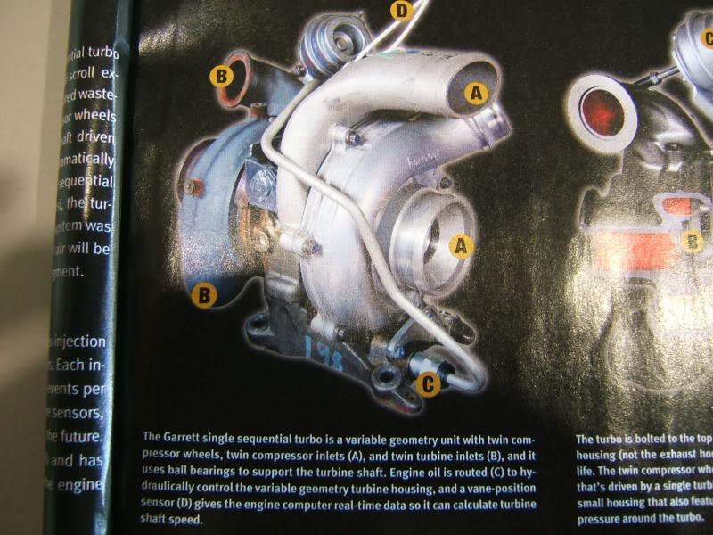

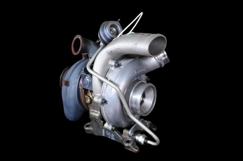

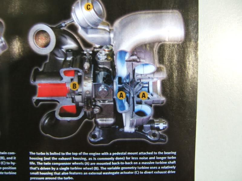

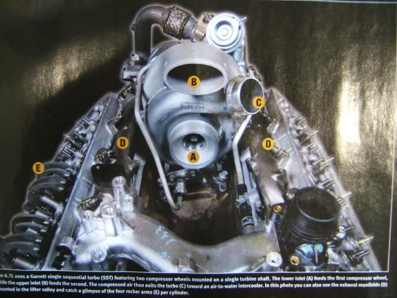

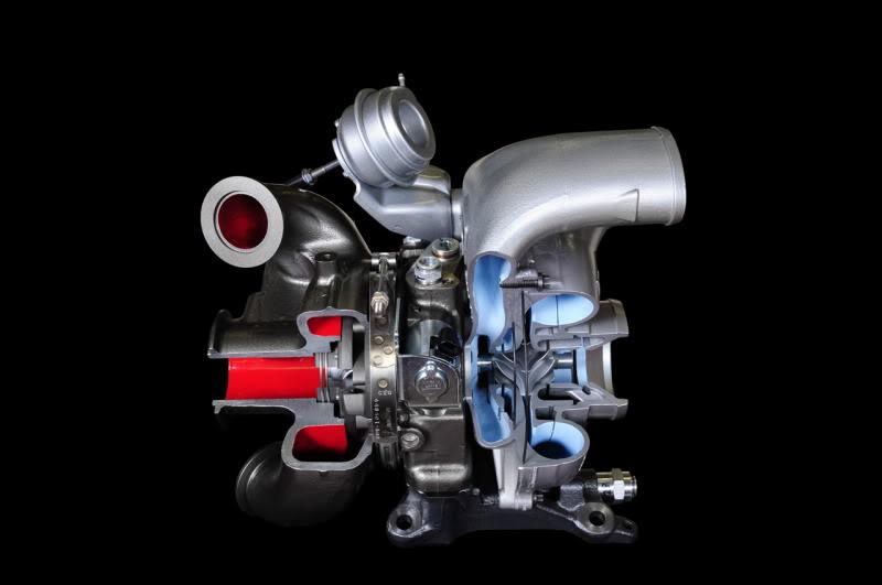

                  Screw your twin turbos, look what I read about last night in this months Diesel Power!
                  Single, sequential turbo forthcoming on a new yankie SUV diesel motor. I'm still trying to work out how it actually works....but I want one!!!!!!!
                  That's a second oval inlet on the top for the second impeller ( on the back of the first one! ), obviously with different geometry. It has VNT on the exhaust as well.
                  It has two exhaust inlets as it's off a V8.

                    crikey cog, can you link us to higher res pics? i wanna zoom. where does the 'backside' impeller feed to? cant make it out.

                      Believe me dude, I'm as anxious to learn about this as you are. As both impellers exit the same outlet, they both dump into the same scroll. Here's the pics from the mag, photographed as best I can.

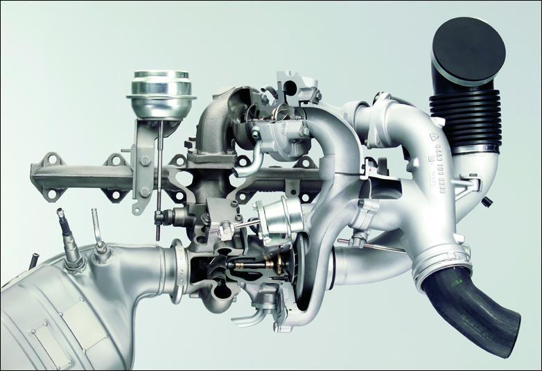

                        and BTW ... BMWs 2.0 TDI twin turbo makes 150kw/400NM .... soon in a few models in Oz.
                          Yeah, the forthcoming twin's give me wood, but they don't seem simpler than the SST - single sequential turbo above. Here's BMW...

                              TT style set ups I've heard and known about for a while, but this SST looks like an interesting bit of kit. all the benefits of twin turbo's, but in a single turbo package?
