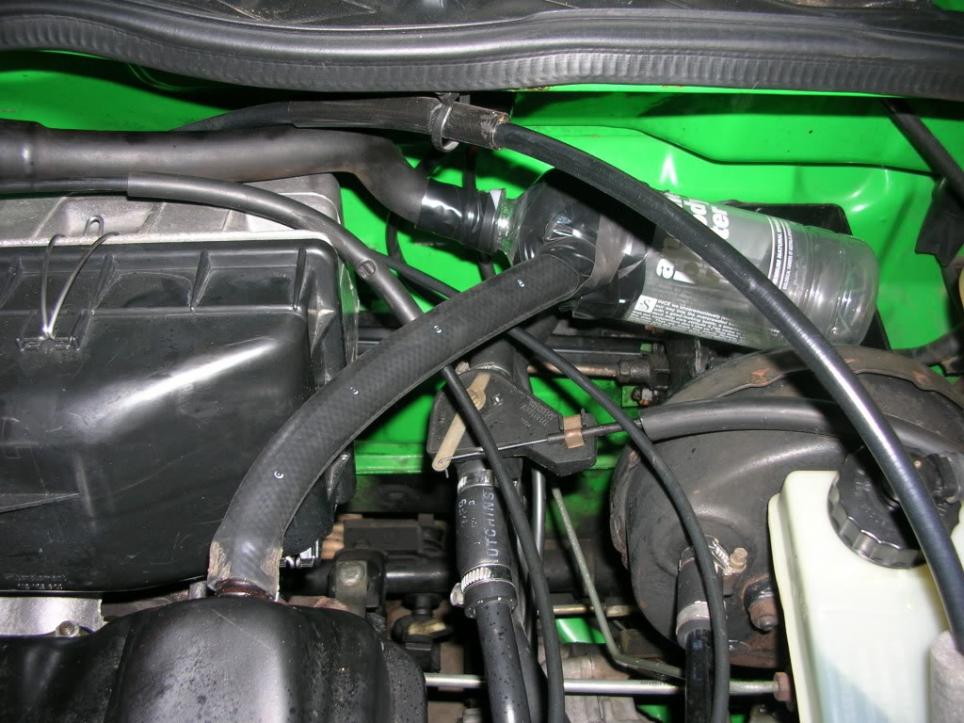

    • #32
      well have done an oil change 25w-60, should be thick enough, changed the oil filter, put in a high tech ghetto catch can (see photo below). havent had the problem happen again, lets just hope it was blow by stuff. thanks for all your help guys!
      • #33
        yeah mate, that looks right, good work.
        you can also try putting a "t" into it and a 't' into the hose from the crankcase to the vaccum pump, and connect them (a later factory revision does this).
        good luck.
        PS - nice clean paint in the engine bay - looks like your cars a real 'minter' (pardon the punn)
