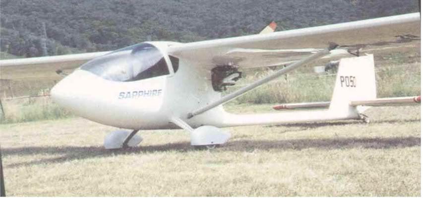

      here is a piccy of one of my aircraft

        this isnt a piccy of mine but I own the same type
