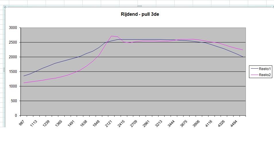

                        mine, polo 1.9 tdi stock pressure, still can't get it
                        BLT engine
                        • #27
                          rpm on the x axis against boost presure (in KPa) on the y.
                          i would think... and in absolute pressure too, not guage.
