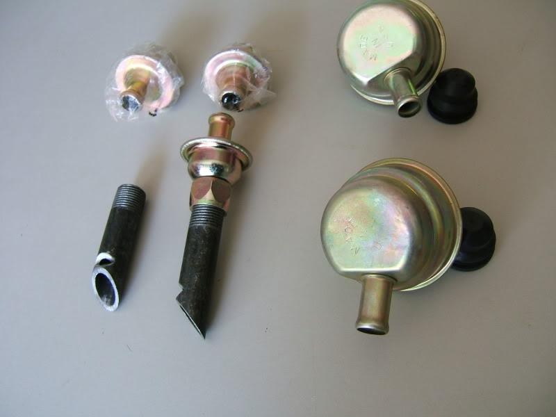

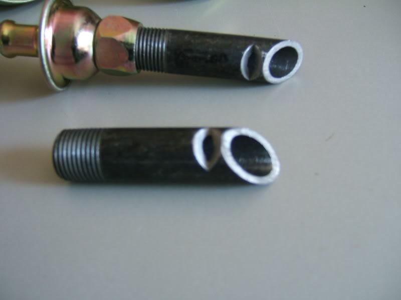

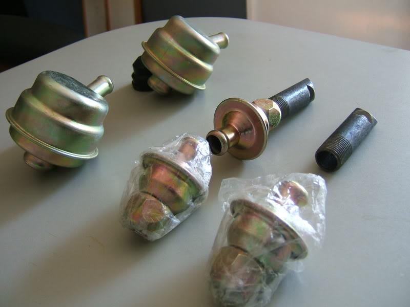

                    '99 A4 Quattro 1.8T
                    • #55
                      OK, a long overdue update, but I'm afraid thanks to being made redundant in May, tinkering is going to be pretty quiet till I get some excess cashflow again! Living off my (limited) fat right now...
                      The upside is I can finish all the things I already have, and I'm busy learning about some new ideas out there that appeal to me, such as compound turbo's. All dreams till I get extra cash again!
                      What I do have is a Moroso crankcase ventillation set I won off e-bay USA, as it has proven difficult to get just the large bore one way valve locally they use to vent oil blowby gas into the exhaust pipe. As this system is designed for an 8, I ended up with a few excess parts, so if anyone wants to follow my lead, I have extra's. I can easily copy this to make a third. The whistle cut faces the exhaust flow, with the pipe entering at 45 degrees from the front, and is obvioulsy designed to cause venturi suction. The valves are very nice, and it's easy to work them by blowing into them, they open very easily in one direction, but are totally sealed in the other direction no matter how hard you try. I'll get them welded in asap, so I can stop smelling oil fumes at the lights. At least my inlet is staying clean!
