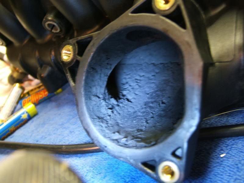

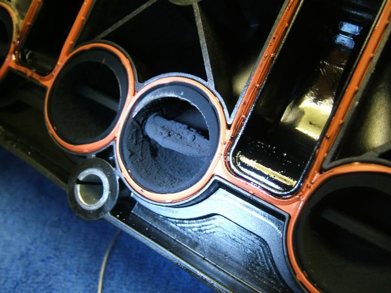

  • This goes out to all the Provent non believers. Stripped my EGR, "throttlebody" and inlet manifold today. Way worse than I had expected, and I've probably got less buildup than most TDI's around, given I put on the Provent from new, and now it's total loss. The clear bucket is just the scrapings from my EGR and throttle flap, got teaspoons full at a time out of the manifold. Two cans of CRC throttle cleaner, some metho, prepsol and petrol later, and it's a lot cleaner. The methanol and water injection will clean up the rest, but if you don't have a Provent yet, get cracking. This is my car at 48k with one from virtually new. SCARY!

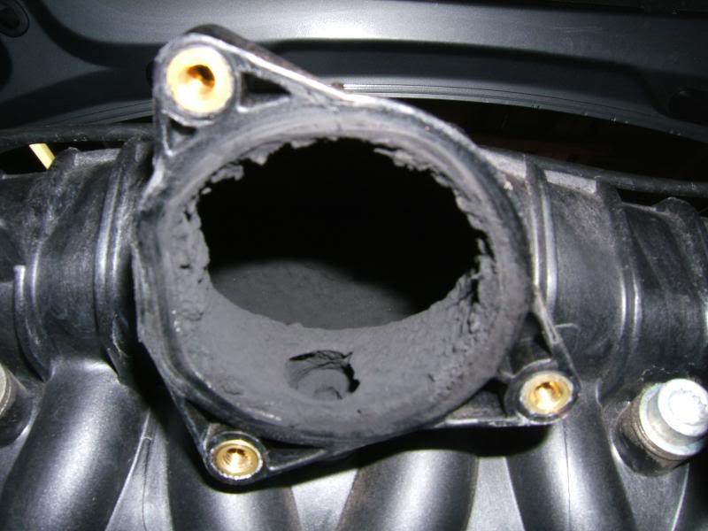

    Interestingly, the throttle body itself narrows down from the nice 2.5" intercooler plumbing to a miserly 1.9", and it's a very restrictive section as the pictures show. Definately the biggest restriction in the inlet, and I'll be glad to see that section gone shortly.

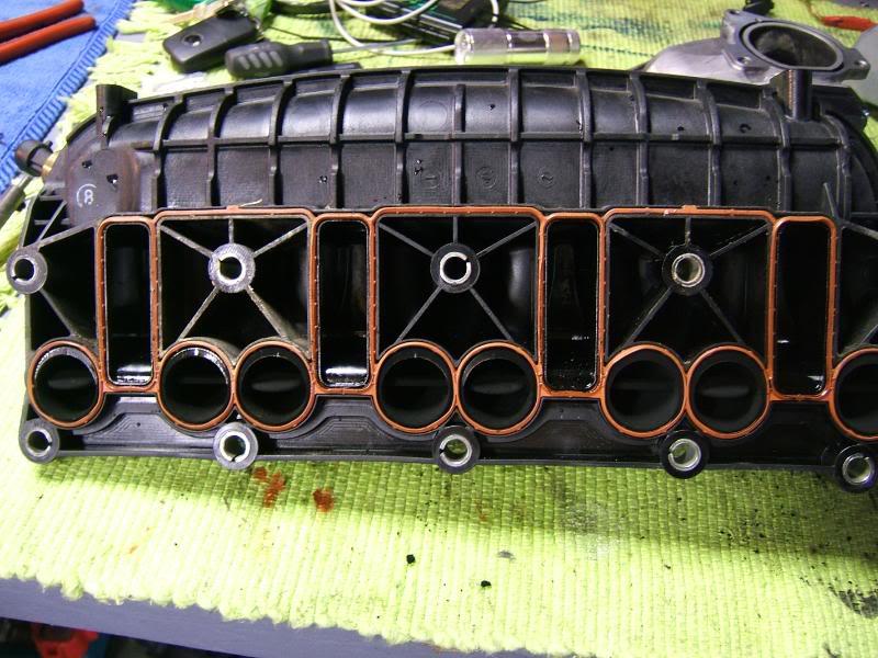

    Pulling it apart isn't as big a deal as I thought, the inlet manifold gasket is the orange rubber o-ring complex, and seemed very reusable to me. O-rings through the entire setup. Just be prepared to spend the arvo getting absolutely filthy. It's all torx, and you'll need a decent set with a M8 size. Bolts aren't overly tight. 5 bolts total hold the EGR and throttle on, with one of them at the drivers rear side going through both pieces. Quite straight forward. I laid the bolts out in the pattern as I removed them though, as the manifold bolts have differing packing washers on them in some spots.

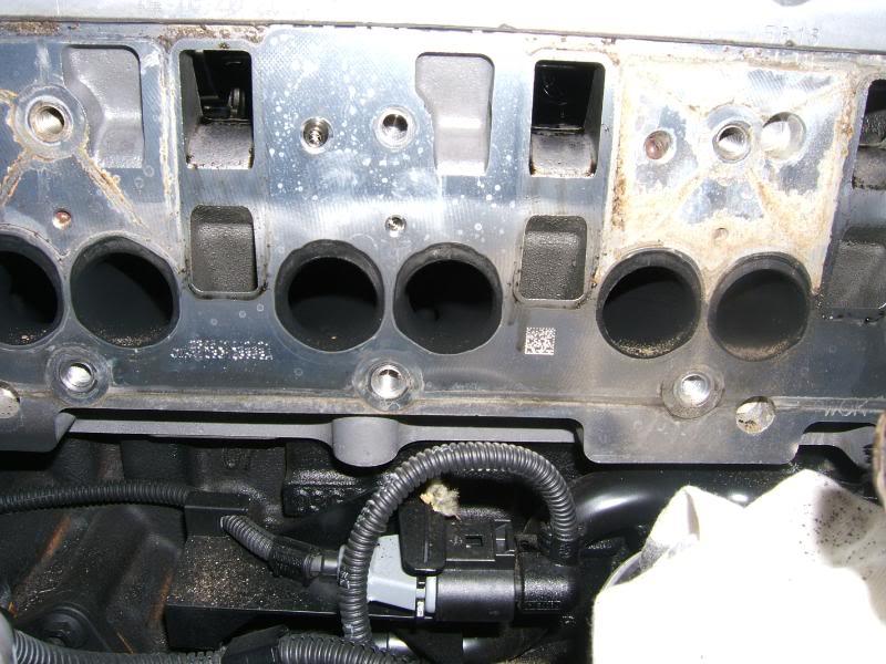

    • The head inlet runners were quite good...hooray!

        • 1.9" with all that restriction in it as well....and the throttle flap is part closed half the time as well....boo hiss!!
          ...and CLEAN, but that's 1.9" from all the rest being 2.5"...and that SUCKS!
          The gunk just from my EGR / throttle flap parts!!!

          • There's a nasty edge in that inlet too, and I dremeled it down while I was in there. My 2.5" OTP electric exhaust cutout I initially bought for a DPF bypass will make a perfectly sized anti shudder valve for ignition off, and it's going to open up the inlet no end.
            Be aware that hole you can see at 6 o'clock just in the inlet is one of the manifold bolts, and I had to clean the hole out to get to it and get purchase on it!
