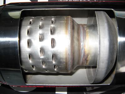

Been looking around for a suitable muff. Diesels pretty much drone below 500Hz just like gassers, but they do have slightly different needs from what I have read thus far. Been researching Magnaflow and other diesel specific muffs, today I found "aero" mufflers, and they are VERY interesting. Seems if you mount it up close to the downpipe, it actually helps evacuate the system. I'm thinking of putting one of the resonated 2.5" versions right up behind the flexi joint post dump pipe, and deleting the stock resonator prior to the rear axle. Dump the pipe to the ground at rear axle level.
Despite obviously being a lot nicer, I just can't see a 1/4" bigger Milltek being $1000k plus better, nor liberating a whole lot more power. Hmmmmmmm
The "XL" version is resonated - but it's just a ceramic interior coating, still a straight through muff essentially. 15cm dia x 66cm long though! Lucky there's a ton of space in the floorpan tunnel, thanks to the R32.
