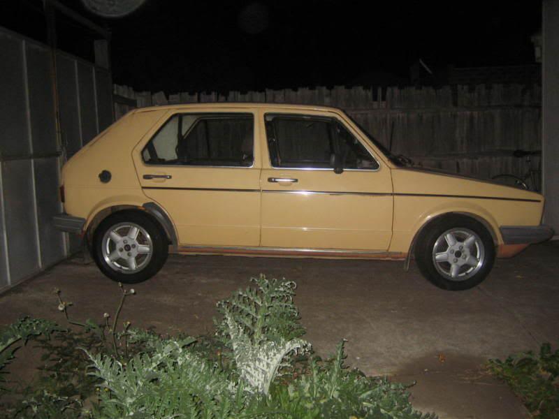

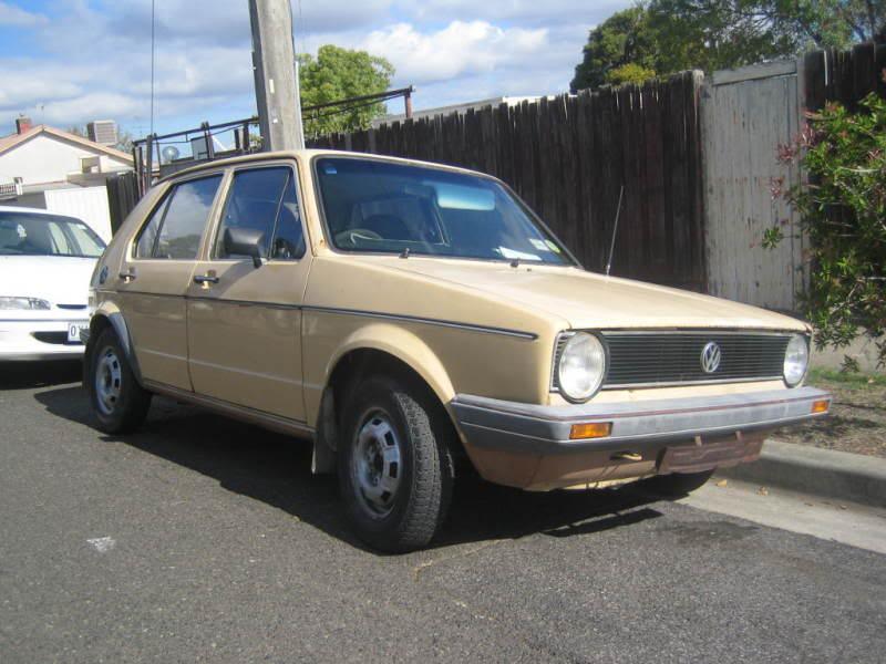

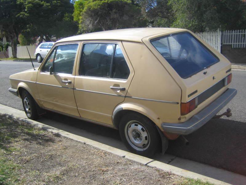

      Heres some photos of the progress, scrubbed up ok huh!
      And with wheels and suspension
      I took it for a spin and from the few roundabouts near my place i can say that it is a vast improvement! Thrilled to bits

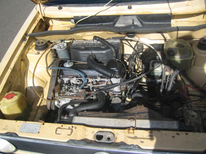

                        I do think that theres a problem with the engine or the engine mounts. The car shakes excessively at idle, things bang and rattle and its generally awful.
                        Is there any way to easily check the mounts?

                              the rough idle is getting very annoying, could it be because one inlet valve clearance is way too big? what else can cause rough idle on a 1.5 diesel?
                              Otherwise, the car is going fab. Its amazing how a car deteriorates when it isnt driven, and how it starts to look better again when its back on the road!
