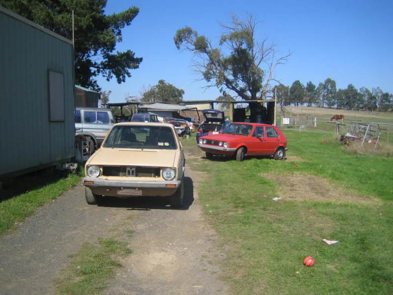

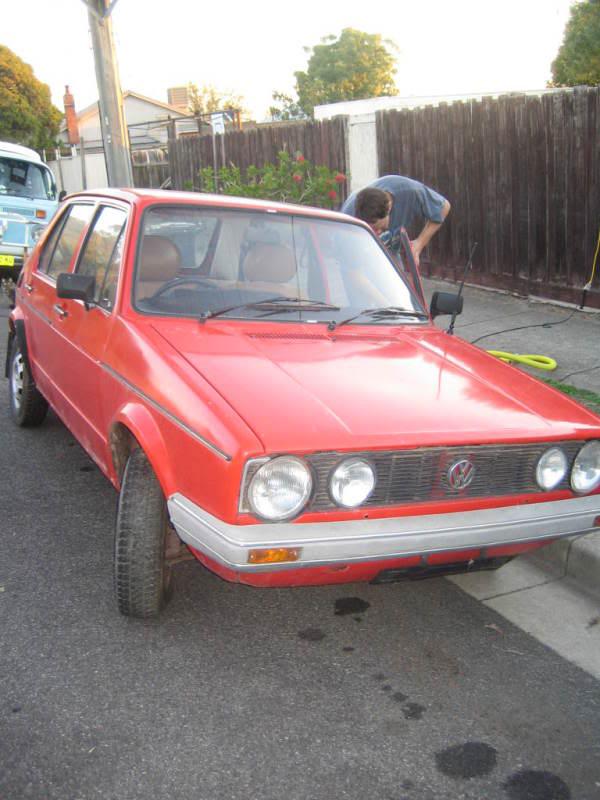

    Hello all,

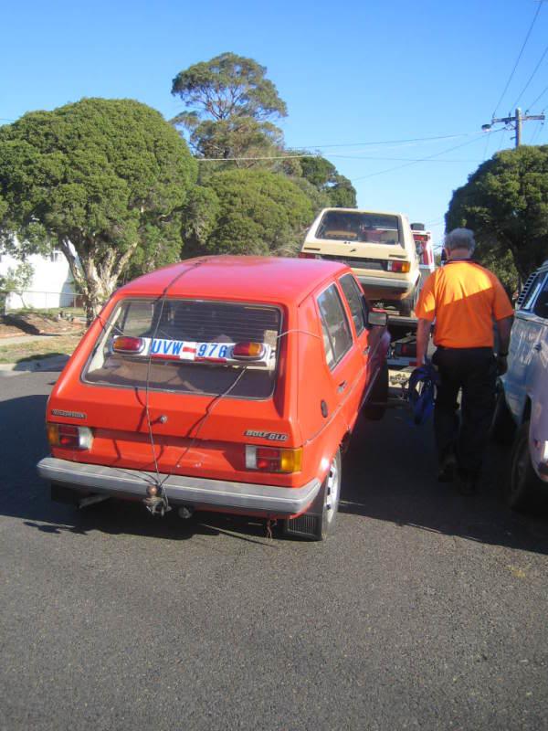

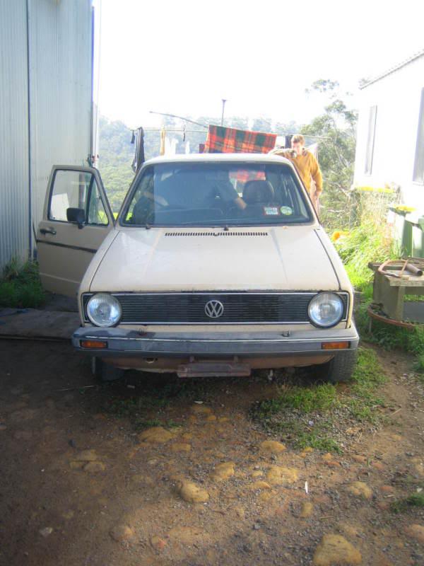

    I have finally resolved my golflessness with 2 Mk 1 diesels. The red one is very tidy inside without rust. The fawn car is a bit shabbier but straight. Looks like I'll be spending a bit more time on the forum, especially in the parts for sale thread

    Nice work mate. Where did you score them?

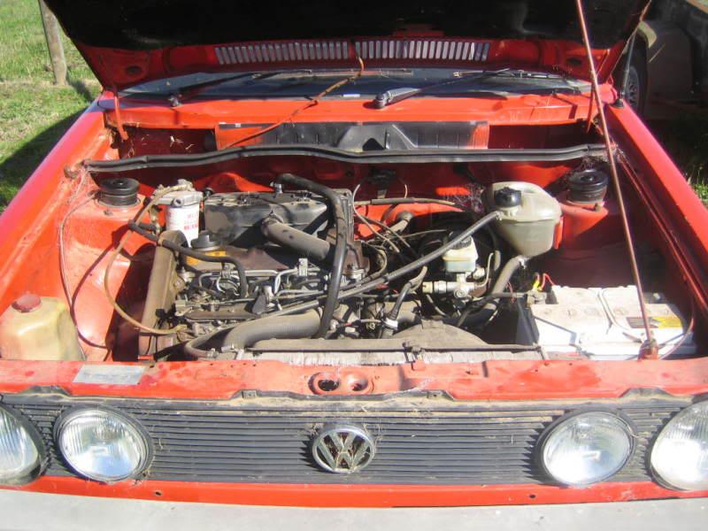

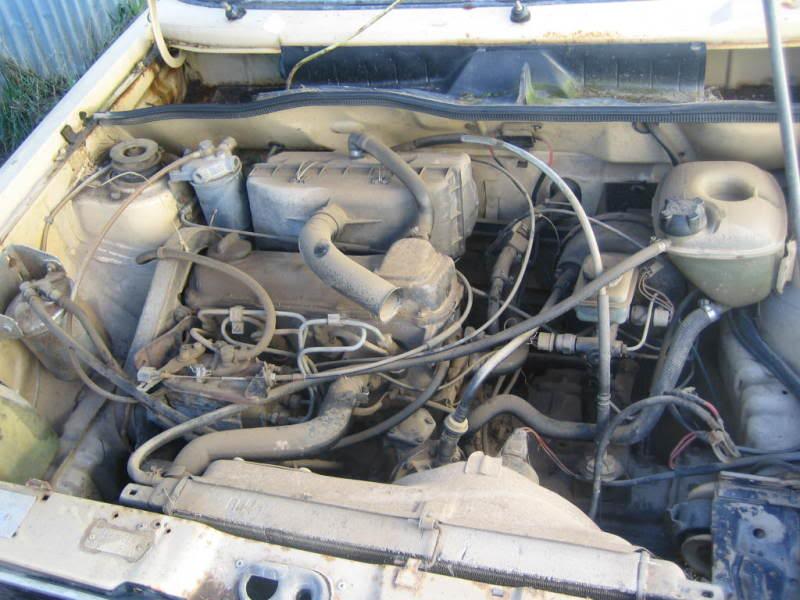

      You gotta love those older engine bays, not chock full of hoses and gadgets.
      Hours of fun awaiting you mate, love a good resto project!!
      Gotta do something about that warm air intake though!
        East of melbourne, on a farm in the hills. They were advertised in the local trading post. I plan to install a 5 speed box, decent suspension and nice wheels and tyres on the red car or maybe have a TD or TDI fantasy. Do you have any bits for sale along these lines? The tan car will most likely be tidied up, roadworthied and sold.

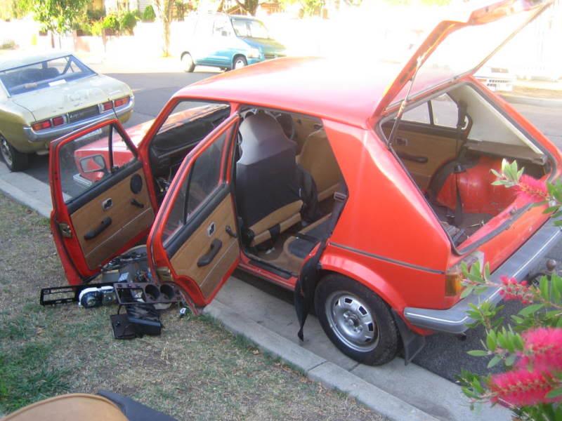

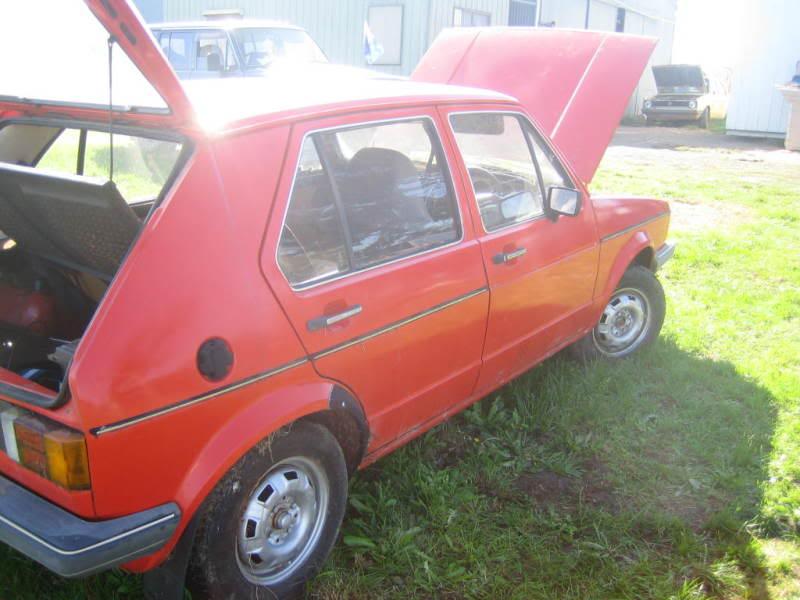

                    On the weekend we chased electrical gremlins all over the red car. Whenever something started working, something else stopped. At best we had the interior light, headlights and the occasional indicator working. We decided to swap the fusebox for a spare and viola! everything was fixed! Then we tested the glow plugs, checked the cam timing and valve clearances, all were ok but still it wouldnt start. We're going to check the injector pump timing next.
                    Today we took delivery of a set of golf mag wheels, tyres and king springs. We also ordered a 5 speed box from Mr Loon. This car is going to be sensational!

                        Today the tan car started! Woohoo! More or less first go too. Cam and valve clearances were checked first and were a little odd. The exhaust clearances were all 0.3 to 0.5 mm but the inlet were 0.2 to 0.3 with the exception of No. 2 inlet which was 0.6!! Any ideas on what this could be a result of?? I suspect that its a rebuilt head. The previous owner testified under oath that it was recently rebuilt motor after a "timing issue" totalled the previous head. It also has a rebuilt pump. None the less, it runs nicely and has little blowby and no oil in the intake.
                        So, we have a tidy car with a shagged motor, and a messy car with tidy motor. What to do........

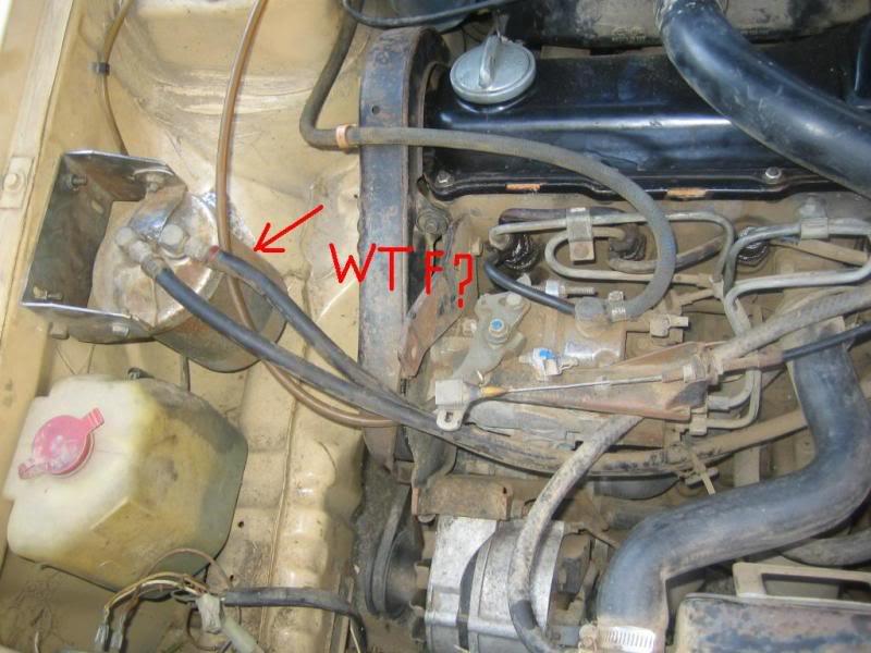

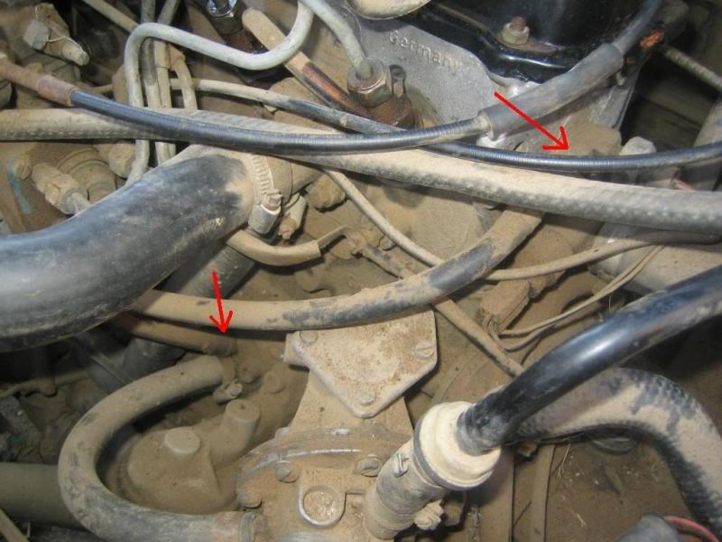

                          What the hell is this thing for?
                          its connected to the cylinder head where the oil pressure sensor is and drains into the block, see below.
                          I assume its a filter but what would filtering oil from this point achieve??? If anything its going to reduce oil pressure...... Its coming off.
                          Also, why doesnt this motor have the coiled oil supply pipe to the vacuum pump?
                            It could be the oil by-pass filter. They don't reduce the oil pressure and if they block up, it doesn't matter. When you start the engine check if it is the same temperature as the engine, if not it is blocked - replace it with the new one. Amsoil type from the Amsoil distributor, they should have the thread reducer if it doesn't have the same thread. Or disconnect it.

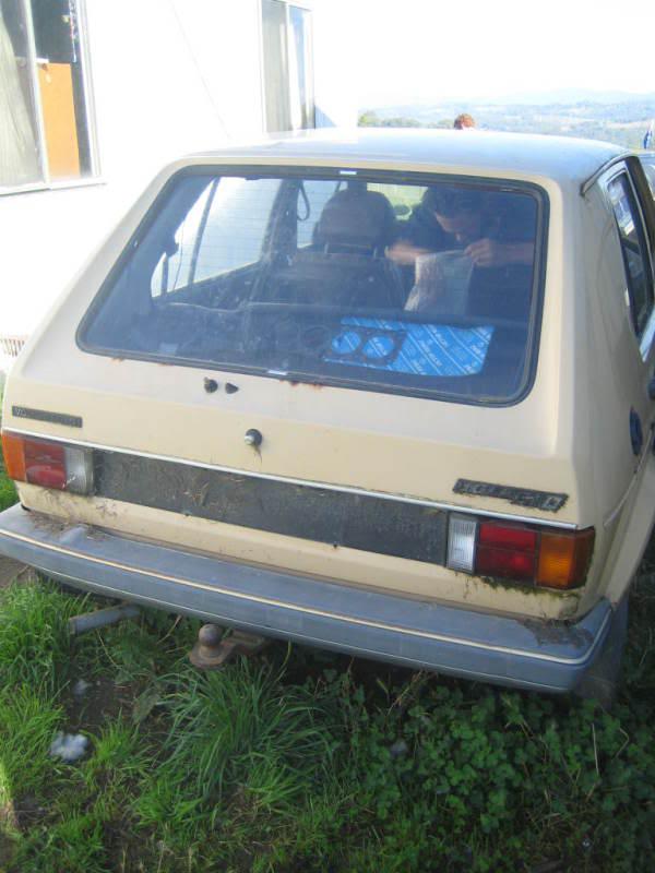

                              The tan car has been started and driven about 100kms. At first it was very smokey but after a about 10 minutes it came good. It runs very nicely, revs well and blows a bit of smoke when floored. The front suspension is shagged though and the gearbox linkages have 1st and 2nd somewhere over with reverse, its pot luck at the lights! This week we’ll do the following in preparation for a roadworthy:
                              minor rust repairs to the hatch and the base of the a pillar
                              adjust gear linkages to make first/second easy to find
                              adjust rear drums and handbrake
                              fit new dampers and king springs, cut bump stop in half
                              fit battery clamp
                              fit horn button
                              make wiring loom for rear wiper
                              replace rear muffler (rusted out)
                              replace windscreen
                              oil and filters change
                              connect speedo cable
                              swap wheels
