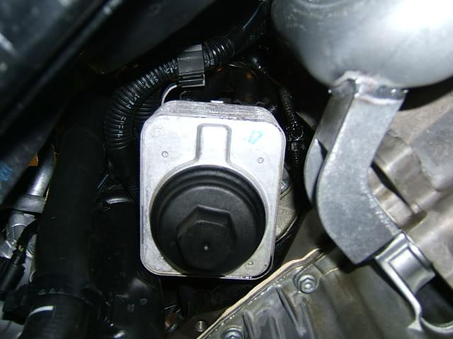

    The bottom cap is something I'd probably say to leave alone for a first go. sure it removes the last 5%, but it also holds the fins of the oil cooler to the filter housing, and apart from being very very messy, it's not simple to just line it back up and screw it back in.
    View from underneath.
    Hi Greg or anyone else that might be able to answer me,
    I changed my engine oil and replaced the oil filter today. I also drained the oil cooler as shown in your photo above.
    What is the trick with 'lining it up'? I simply replaced it the same way it came off...? Is there some trick to aligning it?
    Cheers.

      Nope, it's quite free to spin a bit but best to avoid it rubbing on anything, just make sure you tighten it right up, they are prone to leaking and can make a mess, I often have to do a second tighten after a few drives. There is no special direction, it just needs the bolt tension to keep the seal tight.
