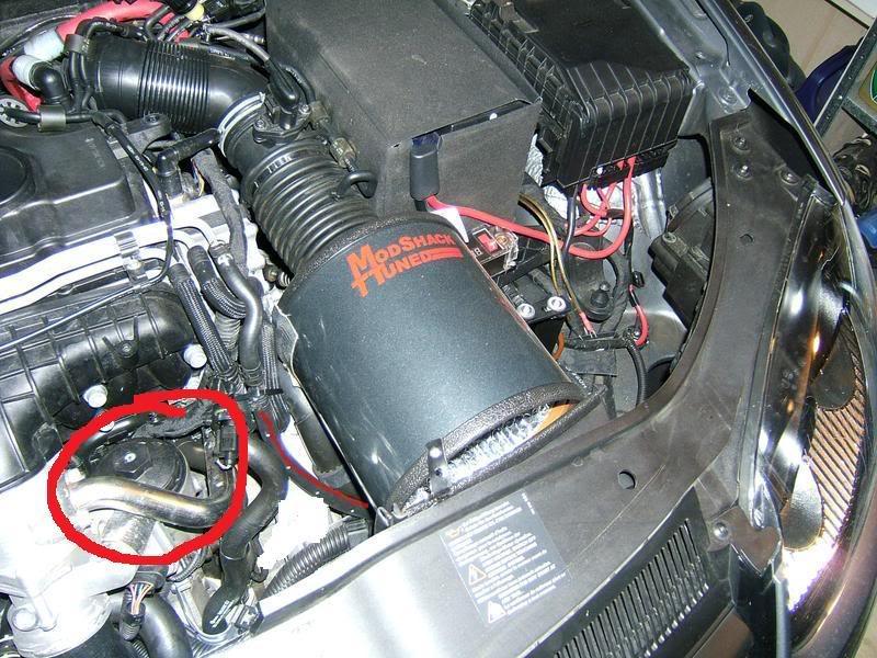

            Here's how you get into the top, where the filter is, and I've no idea how you'd manage it with anything BUT a 32mm socket from your local auto supplier. Oh and your airfliter will look a little different!
              Interesting, looks just like the VR6 oil filter housing, just the other way around and not at the bottom of the motor... same size socket as well if I'm not mistaken.
