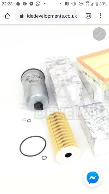

              Does appear to have some sort of drain. Will investigate further.

                Looks similar to what the T4 has.

                    Yes, my T4 has the drain. I drain some fuel in a small glass container & have never found any water or sediment.

                      Hey mate, don't worry about the water drain, filters are fairly cheap, change it every service 100%. We do it like any other filter, on the drag polo's and tuned 1.9's.

                          Yeah thinking the effort just to check is the same as replacing.

                            update on this.
                            so its been about 17,500km since I swapped the fuel filter (the same time I got the car running)
                            I've run 2x 500ml bottles of Nulon "fuel system extreme clean" through it over those km. my mates commented the car stunk from behind after the first two lots of 250ml so I assume it was working?
                            swapped filters (same amount of work as draining as mentioned previously), drained the one from the car and didn't spot noticeable any rubbish or water.
                            Not sure if its connected but I have noticed the wet/moist area at the inline cooler seems to have dried up too
                            run on Shell or BP fuels (normal and "premium") from various fuel stations if its worth noting.
