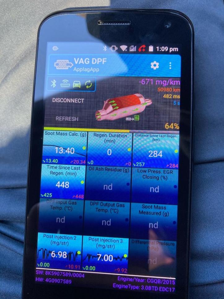

                Just a note to any users of this handy app, they have recently updated the app and made some bug fixes etc, but the main difference is the image at the top of the screen is now much clearer with a new image of the DPF. Will grab a pic soon and upload.
                1st Pic - DPF regen in progress. Notice the DPF image is coloured red which indicates a regen is in progress (it also beeps at you to let you know). The regen procedure had already been running for about 8-10 mins before I took this pic.

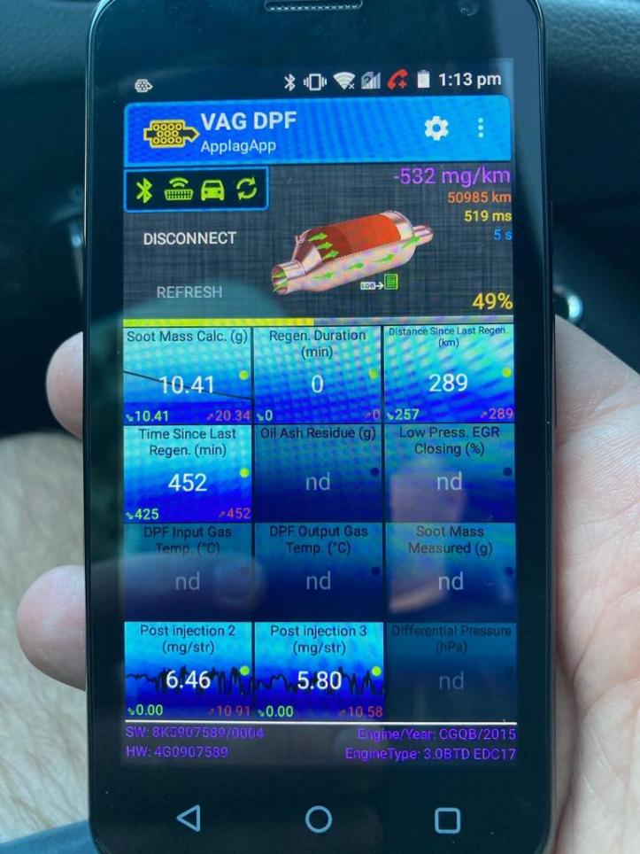

                2nd image - DPF regen still in progress but closer to being finished.

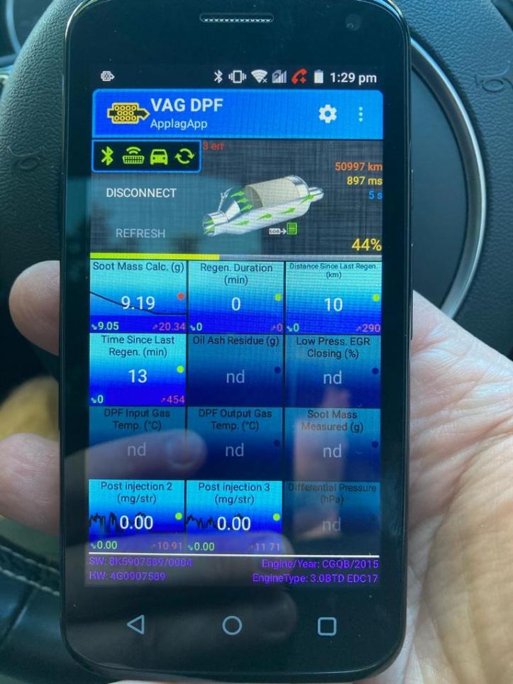

                3rd image. DPF regen complete (note DPF image is no longer coloured red). Also note the distance since last regen info has reset.
