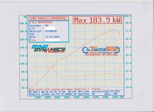

          Stage 1 Bluefin Map
          Hi Guys, Below is my Dyno Graph of a stage 1 Bluefin map.
          No engine, intake or exhaust mods.
          98 Ron Fuel.
          DSG 4th Gear dyno run.
          On the day of the Dyno run the Temperature was 35 Deg C in Brisbane.
