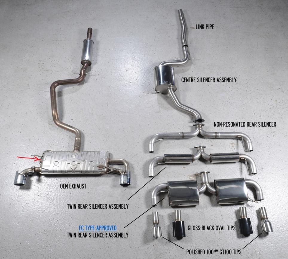

      Found the following photos that show some sort of bypass, not unlike the Monza system on the Abarths
      but they are mechanical and open around 3000rpm
      and
      red arrow shows where the actuator presumably goes
      Would be nice if that actuator could be set in the VCDS or over ridden

              There is a vacuum hose that connects to the catback section of the exhaust. When your turbo goes from vacuum to psi it opens the flap to allow more noise.
              If you want to keep your existing exhaust then some people do the "flapper mod" which they basically tie off or clamp the vacuum hose so it's open by default (when car is on the vacuum closes it if hose connected)
              When you are sick of the noise then undo this.
              I haven't seen a button to control the standard exhaust flap
                Also changing the muffler won't impact your warranty.. It's easy to put the stock one back on without evidence of catback change
