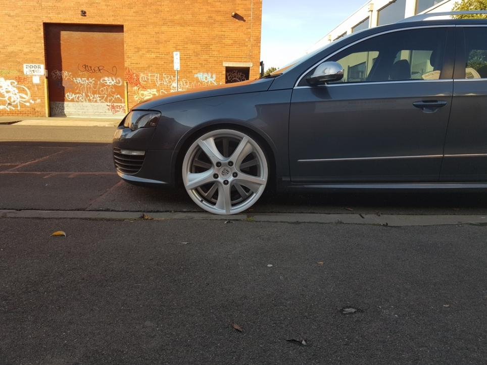

After a little advice regarding fitment of some wheels onto my R36. I am interested in a set of 20x9 et50 rims. They are Porsche Cayenne replicas. Below is a pic with one of them standing alongside my car.

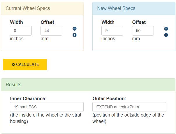

I have used the offset calculator on 1010tires.com and got the results below.

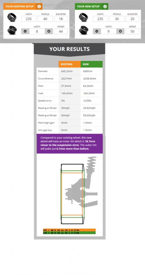

I've also tried willtheyfit.com and got the following result.
Has anyone successfully fitted wheels of the same size and offset? What size tires did you use? I know the PCDs are different so I will need adapters or can I change the hubs? Obviously adapters will change the offset...
Any advice appreciated.
Thanks
