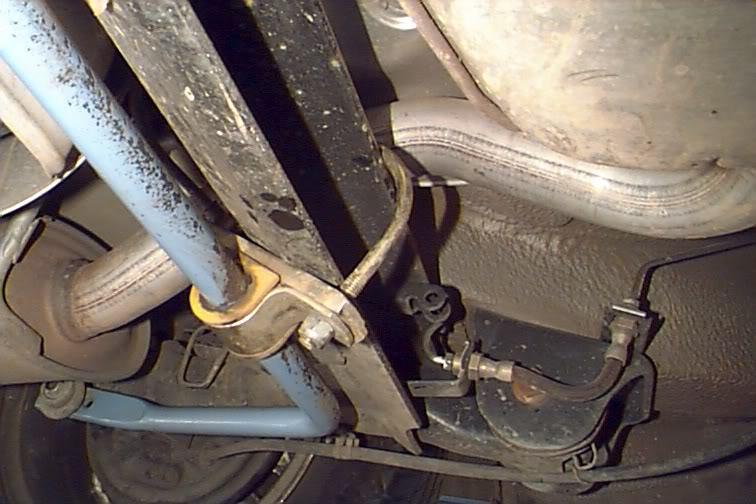

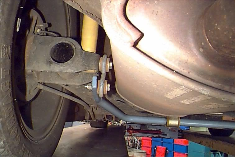

    After realising that my GL is deficient of a rear swaybar I have decided to find one for it, my first port of call is of course Whiteline.
    One problem though... Can a VR6 swaybar fit onto a GL/CL rear track. To better help my question here are a series of pictures which one of the customer service officers have kindly given me of a VR6 with the rear bar fitted:
    Cheers, Branko
    Rear suspension setup is the same throughout the Mk3 models. Pedro bought a Whiteline one during a group buy a while ago and it was only for $190. He's yet to install it though...
