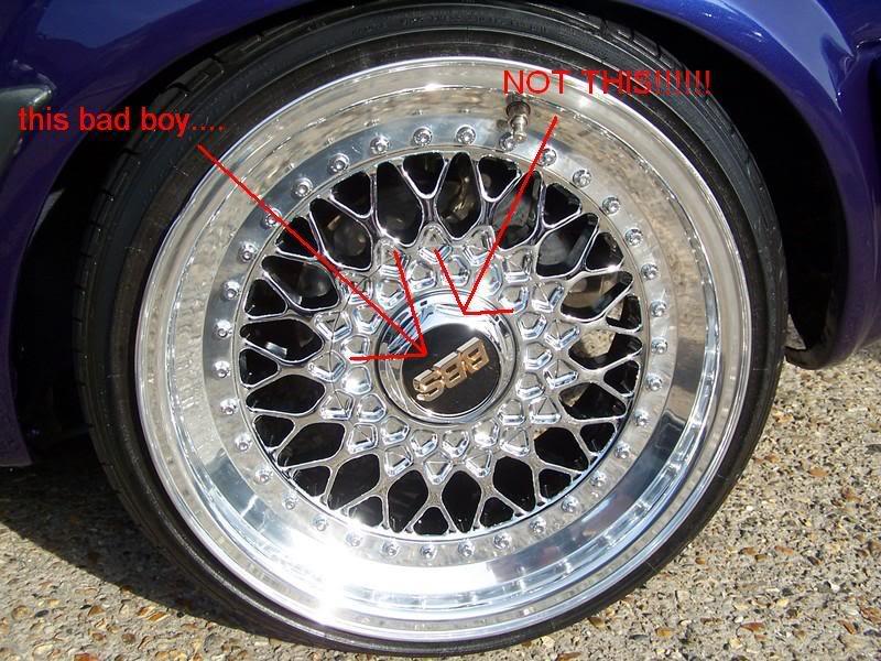

    i would like to know what size the BBS centercap IN the center bolt is... both outer diameter and inner where it clups onto the center hex.. and may i have pictures if you got any

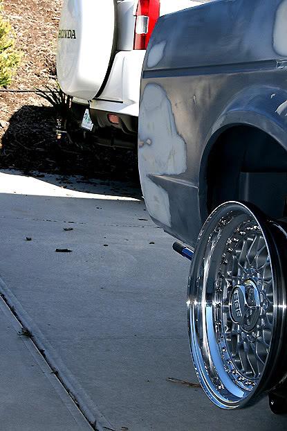

                    these are the wheels im getting but in gold centers

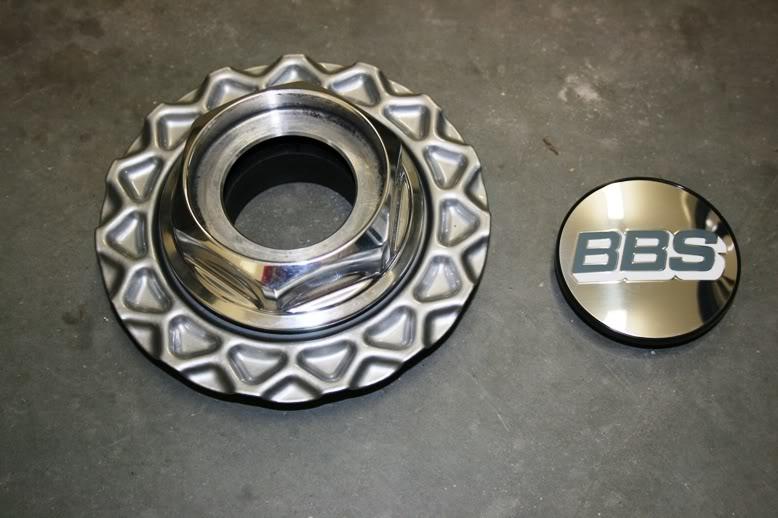

                    this is that the center bolts will look like... i wanna er BBS caps for them

                      Yeah the centre hex nut looks similar to the BBS RS one... though sizing is crucial here.

                        I know you're probably excited and want to order as much as you can for the Cabrio rebuild, but my advice would be to have a bit of patience and wait until the wheels arrive before looking into centre caps. Then you can take a few measurements from your wheels and go from there
                        I've got some BBS RS and they use a 70mm centre cap as pictured below:
                        The diameter of the hole in the hex nut for the badge is 52mm. Check your wheels when they arrive

                            "there the 70mm real bbs caps cut the tabs off and drmemeled out the remember hex till it fit, and glued them in"
                            found out what i have to do to make them fit off a fellow vortexer
