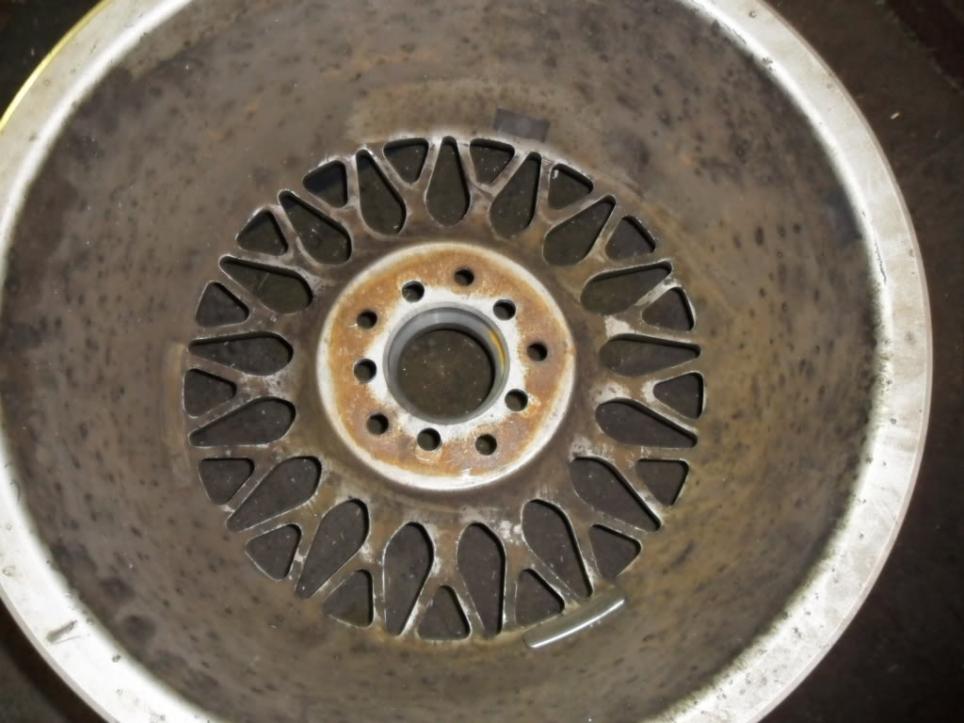

          + a photo of the back of the wheels could be goiod to?
            sorry, no image of the back.

              get an image from behind, that's what we need.
              do you know the centre bore?
                that center bore hole could be a problem when redrillling the wheels, the 5x100 holes may cut into the thread of the centercap.
                  Oh, I think I know what you mean, 5x100 holes are closer in to the centre than 114.3 so the holes may, uh, "overlap" into the centre bore? Sorry, I don't understand what you mean by it cutting into the thread of the centre cap, do the caps have certain patterns as well? Sorry, really new to all these stud patterns and fitment. Would this mean that all mk3's with rs's are running adapters?

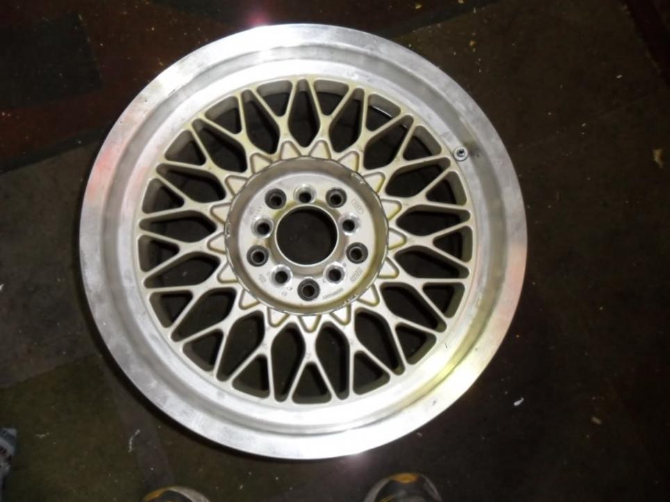

                    yes.... 5x100 would be closer to the center bore.... caps/ bores dont necessarily have patterns, so much as sizes.
                    for many recent VW cars, the center bore would be 57.1mm, and that would ideally be the size of each hole you see at the center of each wheel in your pic above.

                      Those wheels, were they off an FC RX7? My mate had a very similar set (size and colour), and I was thinking about doing it when he was selling them. These would have a ~66mm centrebore as well (which is redrillable). What's the RS model number on these babies? You can find out by reading in between the lug holes.
                      Dom's right, redrilling to 5x100 will more than likely drill into the centrecap thread. In your pictures, notice the big middle hole with the threads where the centre collars and the big hex caps screw onto? A proper 5x100 redrill may drill through it.
                      But then again, these 16's seem to have the smaller centres - these use a different centre collar and smaller diameter threaded hex cap (~56mm versus ~70mm for the larger centres). So you might get away with a 5x100 redrill.
                      It's best to take it out to a wheel specialist to have a look-see and find out what your options are; at the same time you'll get a quote for redrilling. If at the end it comes to having to use adapters, I'd suggest giving these wheels up as they're not the best specs to run adapters with.

                        Pics of front and rear of wheels
                          Aah, I see now. Thanks Rayray and Golf Loon, that really cleared it up for me.
                          And I found out that one pair has 60mm and the other has 70mm centre bore and they aren't flat backed. So that means they won't be redrillable because the new holes would go into the thread, yes?
