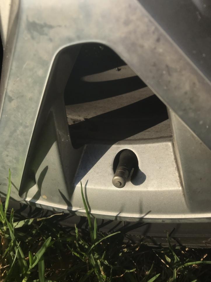

                        hi Doc,
                        my B7 passat alltrack had the little metal silver air caps on the 18" canyon wheels. are these part of the pressure reading style setup?
                        new B8 has standard plastic caps, but i still have the old car so wondering if i should swap them over if its still compatible.
                          The valve stem caps have nothing to do with the TPMS - they’re just a cap.
                            Well there you go, when I got the B7 someone told me that these were part of the TPMS. so I was always careful never to leave them off too long so I didn’t lose them.
