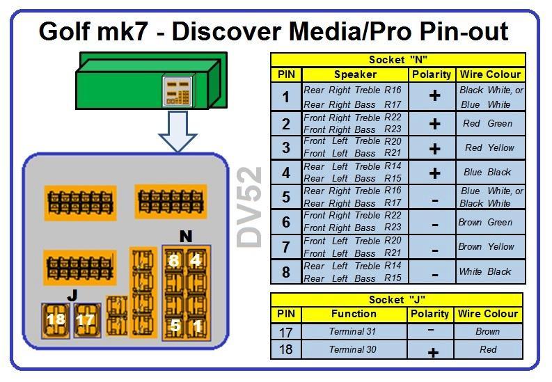

Next job was to tap into the speaker wires coming out of the cars radio - the radio for those that dont know is the unit in the glove box (the unit that has the CD drive slot and SD card slots in it) I purchased a universal radio removal kit from my local auto store that had the right VW Golf removal keys in it that let me remove the head unit - using a guide I found online (attached) I tapped into the the rear right and left speaker wires with some speaker cable which I also ran down to the rear of the car.

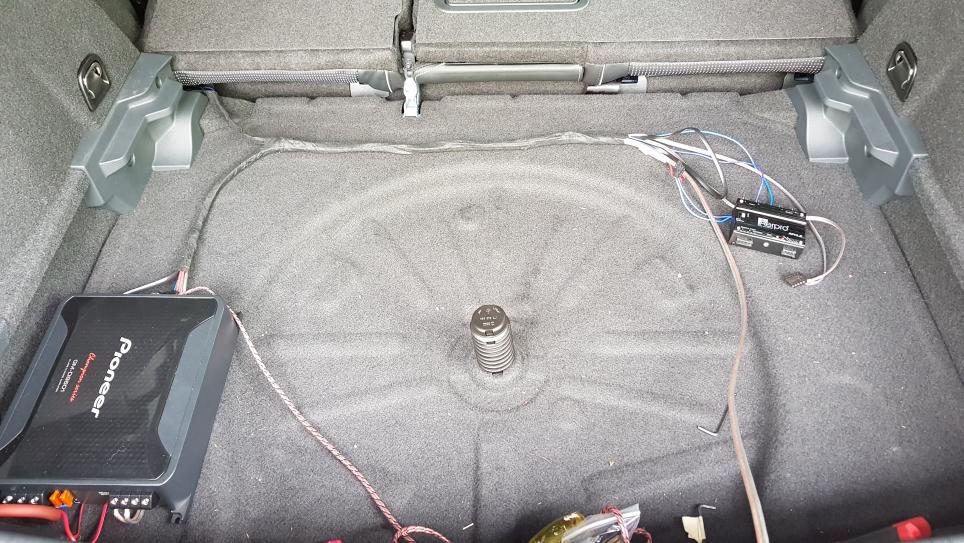

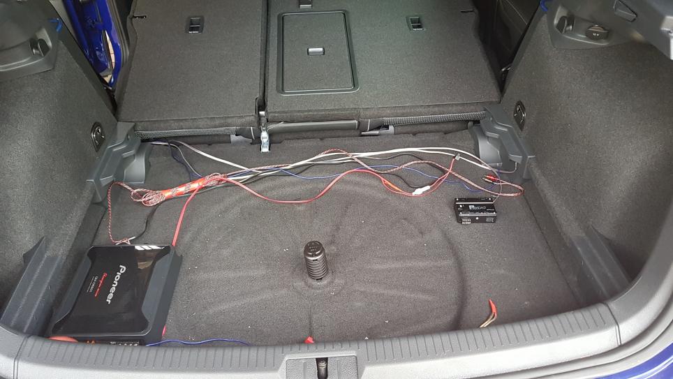

So now with all these wires/cables now in the back of the hatch area (I lifted the rear seat a little to let me get them all under the seat) I can work on the amp placement and wiring needed back there.
This all takes place under the lift up rear hatch floor panel.
Luckily the Pioneer amp fits nicely in the back left hand corner of the hatch, I just needed to trim about 100mm off the foam used to hold the spare wheel removal jack which is easily done with a sharp knife. you can see this in one of the attached pics. I had to make another spot for the wheel locking nut and some spring thing in another part of the foam for those 2 bits but no dramas doing that. The amp then then fits nice and snug in that corner and wont move around as the foam and spare wheel stop it from moving anywhere.
For the earth cable I actually drilled a small hole in the rear right corner of the floor pan and screwed a large screw into this hole with the 4AWG earth cable which you cant see in any of my pics.

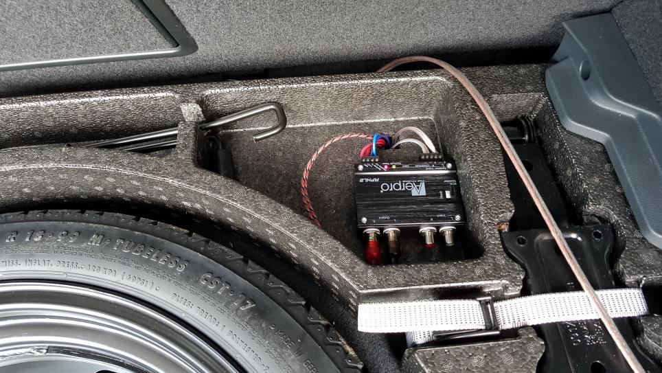

Now to find a spot for the APHL2 line output converter - this is where the speaker wires tapped into the front head unit need to go to - as you can see from my pics there in a nice little spot for it to live in the spare wheel jack foam on the right hand side - I just cut a smallish hole into the foam in that spot and ran all the needed wires for the line converter underneath and up into this spot. With the RCA wires needed in place going back to the amp and power for the line converter (which I just got from the 12v+ 4AWG wire at the amp) and placed all the wires in place and taped them up with that grey automotive cloth tape to give it that OEM look...
With everything in place when opening the rear hatch floor panel you dont see much of the wiring anyhow as all the wires are placed under the foam of the rear wheel tool kit so looks nice and clean. and of course with the rear hatch floor panel closed you dont see any of it at all.

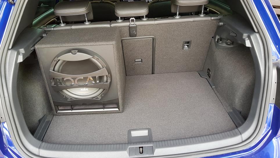

The Focal SBP30 box is pretty big but still fits nicely under the rear hatch panel (the one thats stops anyone looking through the window so see what you have in the hatch area) I cant also still use the larger driver side drop down seat if I need to use that. I have not actually mounted the Sub box to the floor in any way as it is nicely wedged into it spot but is easy to remove if I want some extra hatch space, which I rarely do.
So how does it sound...
Fantastic - the bass levels are now massive and the cars normal speakers now sound so much better since they dont have to do the bass work and having the bass control knob for the Pioneer amp in the glove box is easy to adjust if more less bass in needed. All this for around $550 - much cheaper than a Wolfsburg and no waiting, in fact I think it sounds better than a Dyna Audio equiped Golf Mk 7.5 which I have tried out at a dealer.
