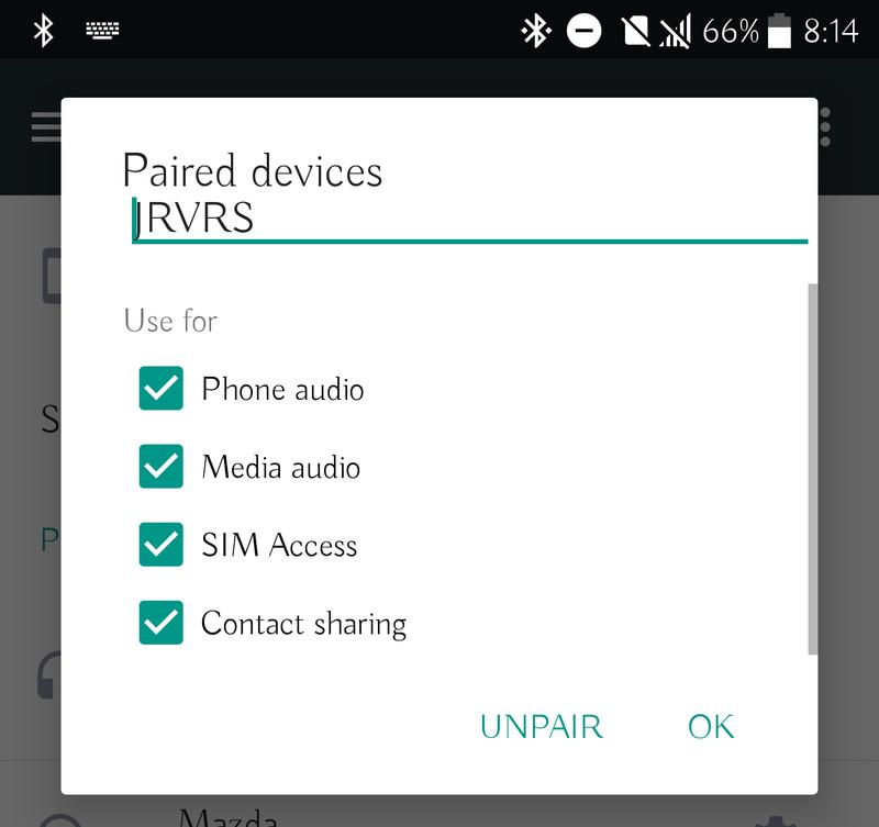

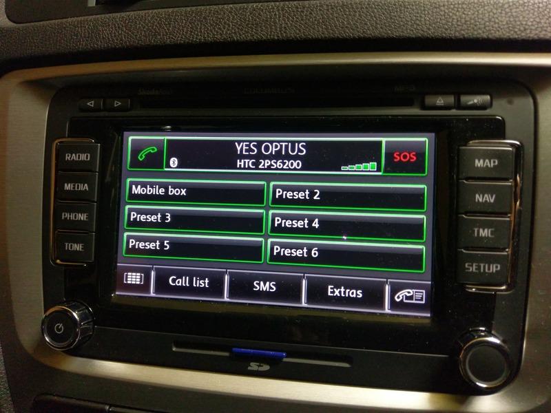

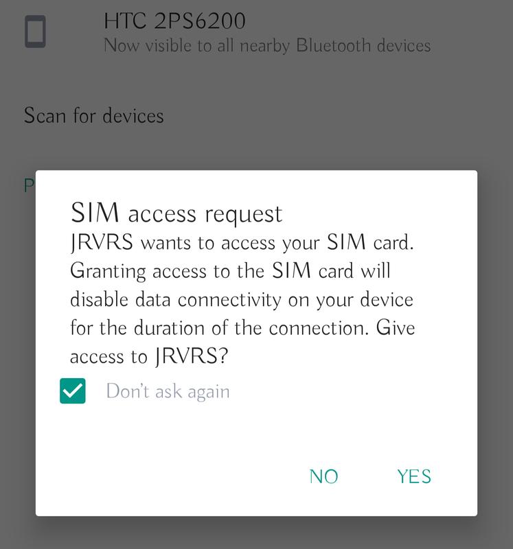

                            essentially, it is the phone that decides if it connects in remote sim access profile (rsap) or hands-free profile (hfp) mode, not the BT module.
                            that's why the 9WZ can operate in either rsap or hfp mode, depending on the phone.
                            when u pair for the first time, and the phone has rsap capability, it will ask u if u want to give the bt module sim access. if u say yes, then the phone will pair in rsap mode.
                            if u say no, it will pair in hfp mode
                            "JRVRS" is the 9WZ BT module.
                            if you're phone has already been paired in rsap mode, and u want to turn it to use the regular hfp mode, go to your phone's bluetooth settings and untick the "Sim Access".
                            rsap mode will say "Premium", u have access to sms and better reception as it uses the external antenna.
