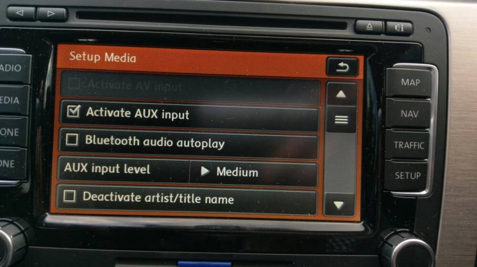

hi there guys just recently purchased my r36 and was looking at getting some audio hooked up through my phone why is there an aux input in the centre console when it doesnt seem to respond, is that because it is not hooked up yet or is it for some other use? or maybe can only be used with the optional extra audio system.. should be able to plug into my phone through headphone jack i thought..
09 VW R36 Aux In plug?
Yes you should be able to select media and then aux on the head unit to use a device via the six port
Sent from my HTC 10 using Tapatalk2011 Skoda Octavia vRS TDI DSG wagon|Revo Stage 1|Race Blue|Leather|Dynamic Xenons w 6000K|9w7 BT|THA475 Amp+active sub|Whiteline ALK|RVC|
There is an option I'm setup somewhere to enable aux I think.
Will check tomorrow.
I don't use mine as I just stream via Bluetooth these days.
But I'll look into it for you.
Check that option in setup/media2011 Skoda Octavia vRS TDI DSG wagon|Revo Stage 1|Race Blue|Leather|Dynamic Xenons w 6000K|9w7 BT|THA475 Amp+active sub|Whiteline ALK|RVC|

It could be a coding issue, it could be a bad cable.
I'd get it looked at with VCDS and see if there is an open circuit on the aux port. If not check the coding.2011 Skoda Octavia vRS TDI DSG wagon|Revo Stage 1|Race Blue|Leather|Dynamic Xenons w 6000K|9w7 BT|THA475 Amp+active sub|Whiteline ALK|RVC|
