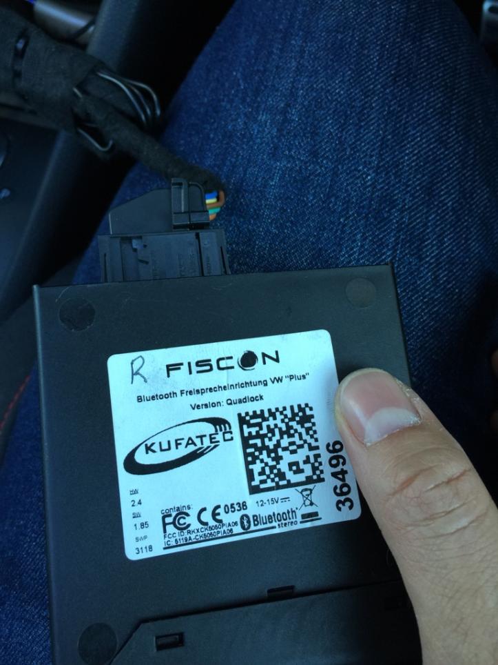

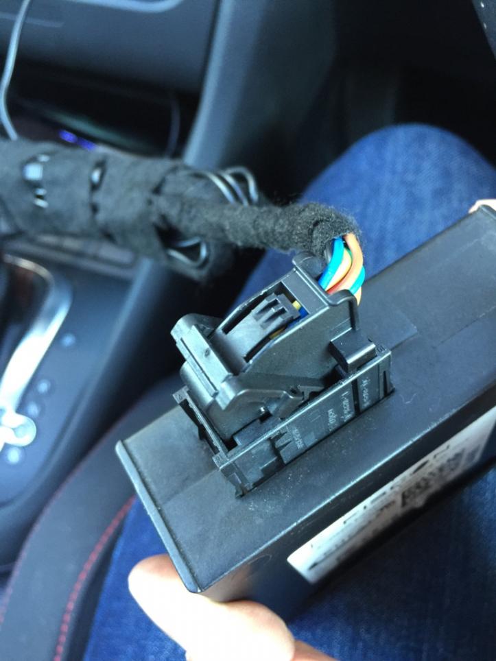

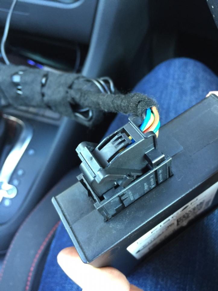

                Ok. Thanks for all the advice. It's worked! Used an old plastic trimming tool I had from an old car seat cover set to pry open the cover and low and behold the Bluetooth unit was hidden behind the head unit. Disconnected the plug and reconnected again to the Bluetooth control unit . Then just had to pair the phone again and it works! Very please with myself and thankful for the help. Cheers!
