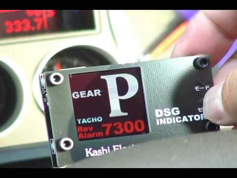

    A great example of what I'm trying to do has been created (using a pic chip) by Hitoshi Kashima.
    Hitoshi uses his to do boost, temps, rev alarm and some other functions. I'm only interested in the gear. He is selling his design. I have no interest in selling anything...I want to help other do make their own.

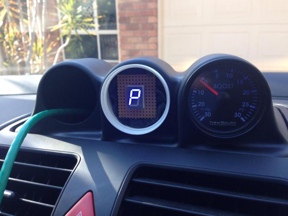

    I have written Arduino code to run a seven segment led display, which will display the chosen gear. The whole unit will fit within a 52mm standard gauge form factor to fit into my New South dash pod.

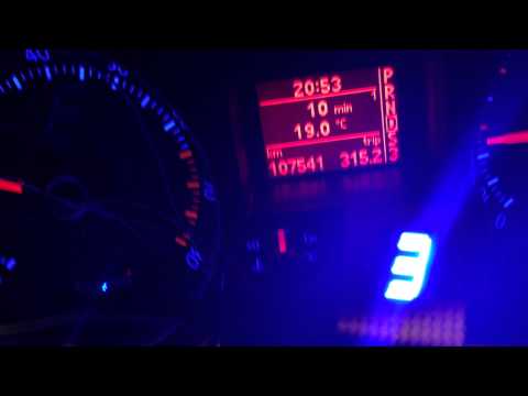

          I'm pleased to report that I have the gear indicator working. With no noticeable bugs. Will post a video tonight.

                As promised...sorry for the poor production quality.
                  Thumbs up Karl. Well done.

                    Moved the seven segment display up to the gauge pod. Thanks to a lid from a deodorant can. Its a perfect 52mm
