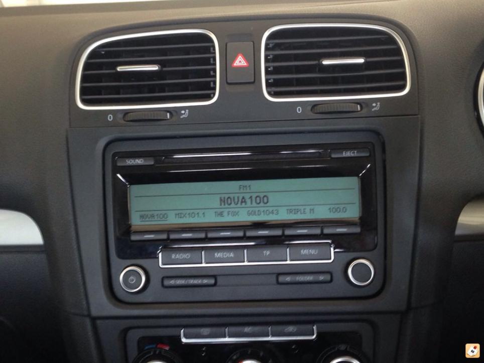

    I have purchased an RCD510 Bosch off eBay and am picking it up tomorrow. It comes with all adapters and cables which is good. I managed to pick it up for $250.
    However, In the ad, the seller mentions that I will need to code it to my vehicle (2011 77TSI) however, from what I've read on the forums its a straight plug and play swap. Will I need coding or is the seller clueless?

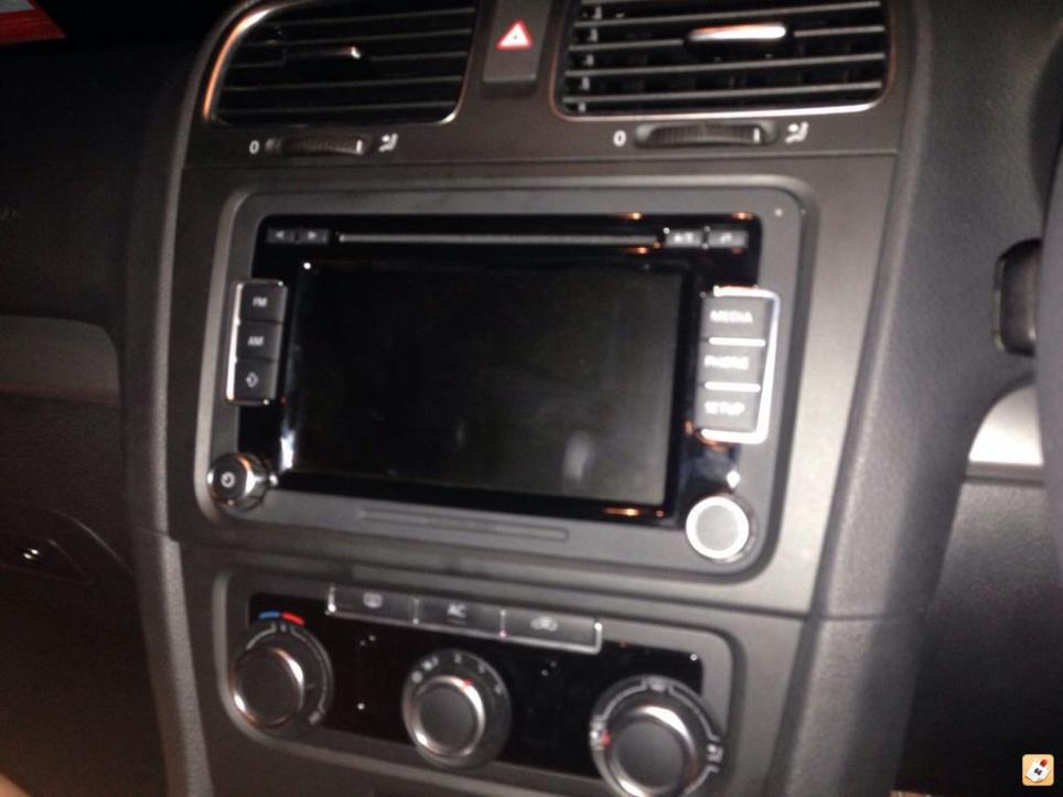

            All done, such a simple yet effective mod
