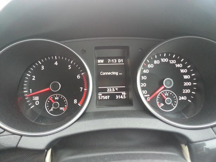

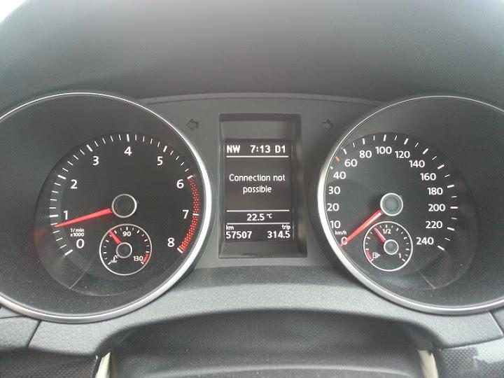

    Hoping someone can be of assistance, just received my shiny new phone and decided it was time to connect to the car's Bluetooth. Only to receive the error "Connection not possible" and "Non compatible handset".
    Has anyone seen this before? Is there a resolution?

    We've had similar issues with the S3 4G (whereas my old S2 never missed a beat in this regard) - I think it's because of the new Bluetooth 4.0 power saving features on the phone. I find that after turning bluetooth off on my phone and then back on, I can connect ok. I purchased a programmable NFC tag that does this for me and attached it to my key ring. http://tagsfordroid.com/

      Thanks Ryan_R, that seemed to do the trick. Have spent some time playing with it and it seems like that first connection needed the BT on the phone to be just turned on. Now that the connection has been made they are talking together nicely.
