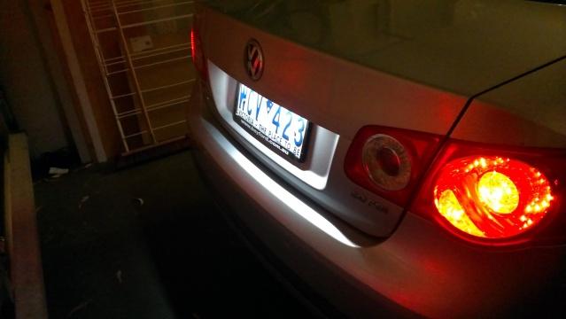

    Installed these LED lights a couple of months ago...
    And now they are doing this....
    MKV Volkswagen Jetta LED Licence Plate Lights Playing up - YouTube
    Any ideas why? Bought them off a forum member too...
    Should I just start again with new bulbs?
    '06 Jetta TFSI
    that is weiiirrrddddd, i don't think that is bulb related, possibly something else

      What sort of LED globes are they? Are they just generic ones off Ebay? If so I'd say that they are gone. The LEDs should duty cycle in normal operation (thats why if you look at LED DRLs through a camera, or when you watch those slow-mo videos on TopGear you see them flickering and so on).
      I would just buy half a dozen of them and keep some spares for when they do fail. Which they will. Because they're cheap.

            These are just the festoon bulbs, but I didn't get them off eBay, I got them off forum member XQUIZT, who I inboxed and is now sending me out a replacement pair! Kudos! But he said he hadn't seen this before and he uses the ones he sold me and his are working fine. So I'll see how those go.
            If the same thing happens I might need to look into getting a more expensive pair with housing (even though my Jetta already has a housing?).

                Yes, put the normal globes back in.
