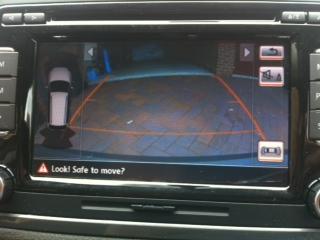

              I had a RVC and RCD510 retro-fitted to my Tiguan about 2 months ago. According to the guy who installed the RCD & RVC, the RVC camera is genuine parts and the head unit is Bosch RCD510 made in Portgual. I also found the image is dark on the screen and it's hard to see especially during day time. I've already adjusted the brightness to the maximum but it didn't help. I've started giving up on the RVC and switch back to the OPS, because the RVC is not useful to me.
              I'm not sure if it's to do with the unit / camera or it's the quality you get if use RVC on RCD510. Some people suggested to switch RNS510 (or the Chinese clone ANS510), but seems it's a waste as it's only 2 months old.
              Anyone had the experience to share?

                        photos added:
                        Tiguan Pacific MY12

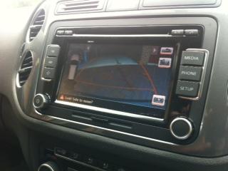

                          photos upload again
                          Tiguan Pacific MY12
                            The pictures were taken yesterday when it's cloudy. The image is worse when it's bright on a sunny day, and you'll hardly see the screen.
                            The first photo was taken from the driver seat. The second one is perpendicular to the screen.
                            Tiguan Pacific MY12
                              Looks like the basic OEM RVC has been installed. From the pics above I doubt if a rns510 that has a higher res screen and brightness contrast controls will give a substantially better pic
