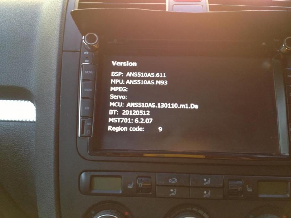

      • Audiosources tells me M93 is the latest, no M94?
        This is mine from the 11th of Jan .

        • Originally posted by bazzle View Post
          As I mentioned before I get my firmware from my technician, the sales staff don't always get them on time because it's not essential for them. My service is paid for good reason

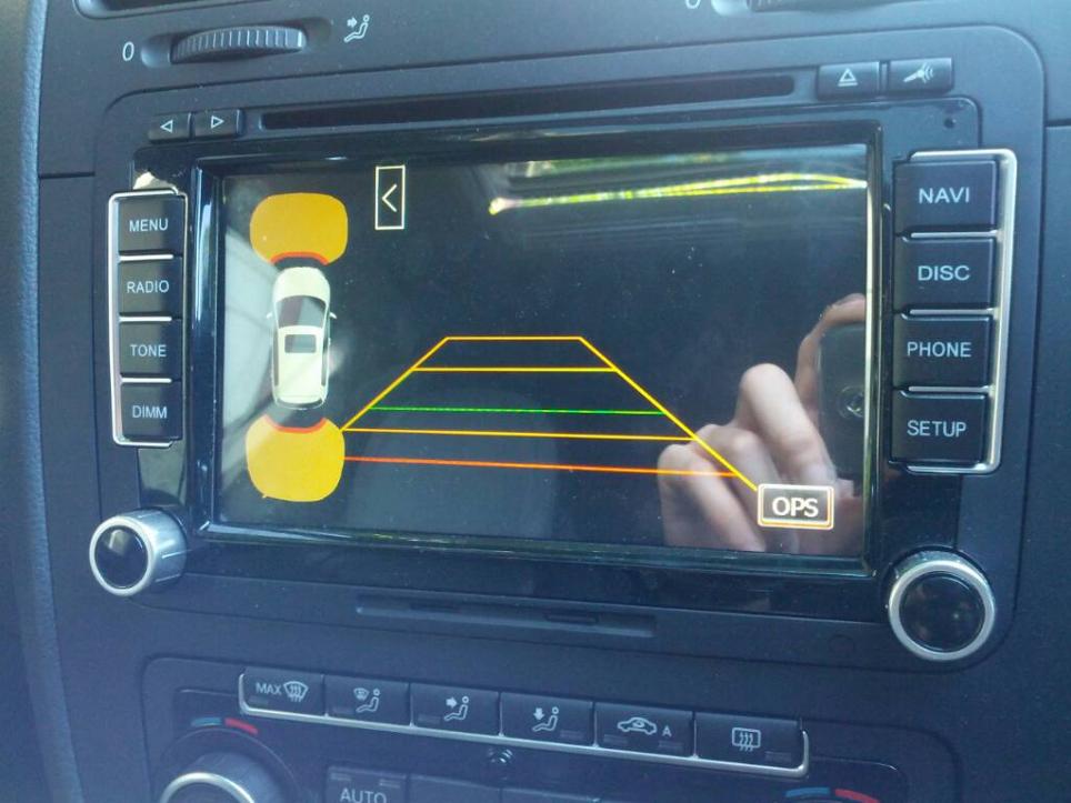

          • I have the "M: unit and with the latest firmware I now have (did not before) the RVS system screen pop up and radio turns off in reverse. How do I kill this since I do not have sensors OR a camera? The old firmware did not do this.. and I liked that. The new firmware is also glitchy with switching from NAV to SD/RADIO/etc. Can I go back to the old firmware? This new one is nothing but problems for me and no fixes (other than the delay time is finally fixed when navigating your media menus)
            • Originally posted by DSGVW View Post
              Yes I have just been notified of the reverse camera glitch, this is related to the new MCU, seems in applying the black screen fix they did something to the RVC detection. Working on a solution now but the MCU cannot be un-updated because the unit detects if your current MCU is newer. You can however flash to the previous MPU if you don't like other parts of the update but can you elaborate on the glitchy nav / radio / SD switch?
